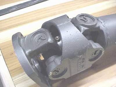

Old Oct 23, 2014 | 05:50 AM
drowssap's Avatar
Posts: 9,298
Likes: 318
From: Boston Strong
like this:
Attached Thumbnails Driiveshaft Question-cid_001a01c1e1147ac830608b85ea43bones.jpg
