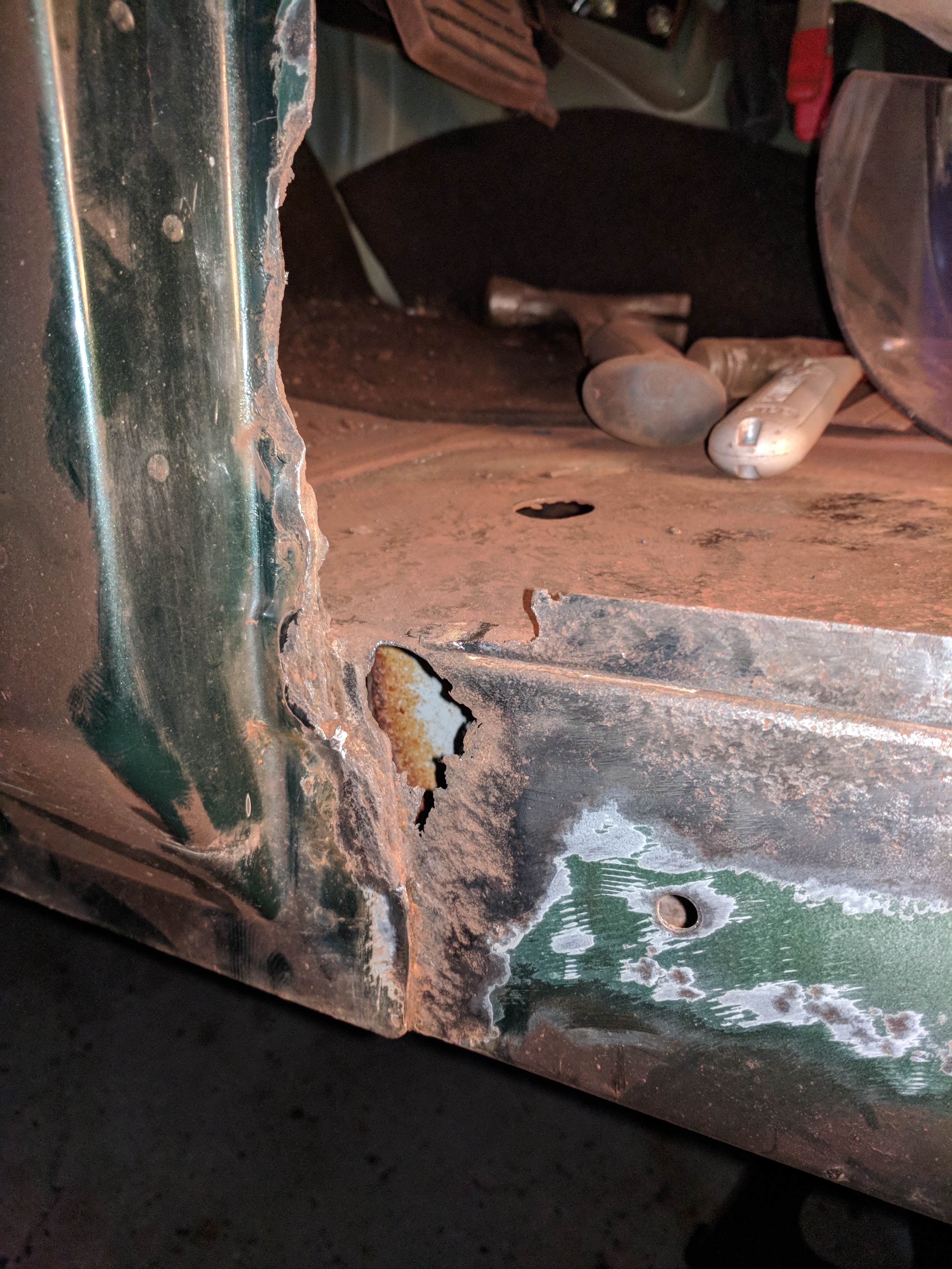

I have done the best I can searching all forums and threads to find a "best" solution my current rust problem. I have been working on my first Land Rover; 2004 Discovery 2 with 62K. I was in the process of replacing the rear 1/4 chassis. While wating for the chassis to make its way here to the States, I have been doing some minor fixes, upgrades, and cleaning. I was working on the driver side seat heater when I noticed some rust on the lower left rear seat post (see photo). I removed the seat and repaired it. Out of pure curiosity, I pulled up the carpet and found...dejection, pain, and pending sorrow (see photo). 90% cleaned up fine with no structural damage - easy grind, treat, and seal. It's the 10% at the juncture of the floor panel with the A column and the weatherstrip sill that has me looking for a better way to proceed. I have ground out the core rust of the area, but haven't done any cutting. (see photo). Is there an easy fix or right way to fix this area? Any assistance woud be greatly appreciated. Cheers.

There are several ways to fix it, you could cut out a rust free panel from the junk yard and patch it in if your good with welding, you could skin over with new metal which is not as good, but my biggest concern would be to check why it’s so rotten. I found 2 d2’s that we’re that bad in that area because water was coming in from the windshield. Be sure to check that first. Stop the water from coming in and check the A pillar and even the cowl and hood hinge mount

This is a patch panel I installed on my buddies d2 with a rotten floor. Made it from an old steel shelf. Riveted it in spot, coated it inside and out with seam sealer and painted it with undercoating
