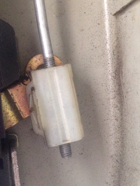

Here is the rod with the screw thread on one end. The other end is what needs unclipping.

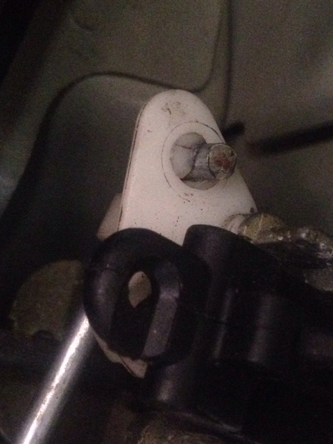

This is the top end. Same level as the handle outside.

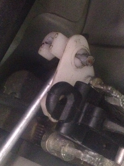

Can't see in this photo, but there is a swiveling plastic clip which holds the rod in the hole. It needs teasing off the rod. It's a bit tricky and in doing mine the whole thing just came off. I think I'm a bit lucky not to snap the plastic bit. It's quite hot out though, so that might have been in my favour.
What it should look like when it's swiveled round.
Now the rod just falls out of the hole.
Turn the rod, as Abran was saying, which ever way it needs to go to adjust. The rod pushes down, so mine had to unscrew, to get more 'push', earlier in the handles movement. They obviously come fully adjusted the other way. So it's great this is as it is.
I undid mine about 5 threads.
