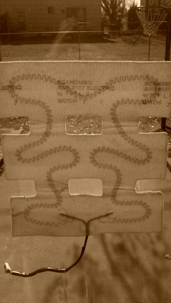

Default seat heater pad
here is what the heater pad looks like.
