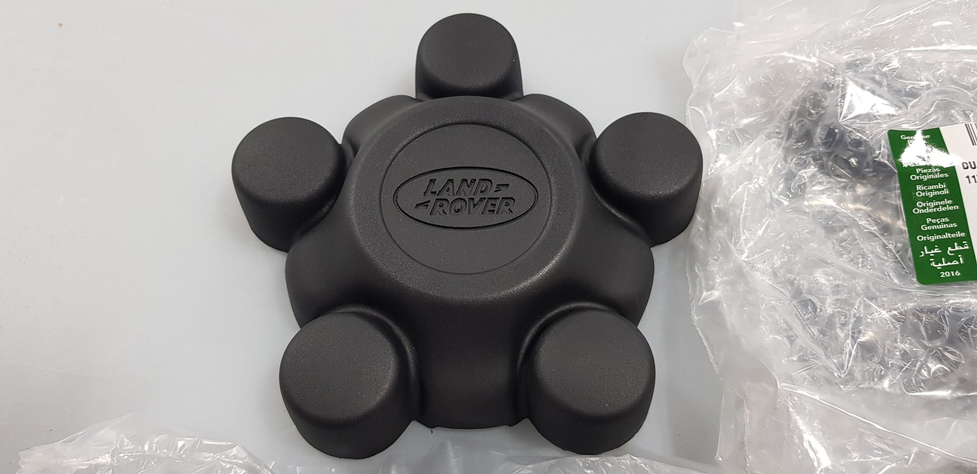

I purchased 5, 16 inch Terrafirma steel wheels, 23 steel lug nuts and 4 genuine center caps for said wheels and they do NOT FIT. The part number for the caps: DTC100810. I've seen pictures of them mounted onto these steep wheels but for some reason they dont fit with mine. Are there different sized center caps? Or do I need bigger lug nuts?

I bought them from lucky 8. They were black so I had them zinc coated and powder coated white. I found out later that Rimmer Bros has white steel wheels available in the UK.
I'm still trying to figure out what's up with the center caps. Seeing how the bolt pattern is the same and these caps are compatible with Disco 2, why then do the caps not snap in place over the lugs? The caps are too big.

Looks like that cap might fit stock lug nuts, try that.

Called lucky 8 and they informed me of 2 different types of steel lug nuts. The ones I ordered are not compatible with the LR center caps. So I ordered 23 of the lugs that will allow me to fit on the center caps.
