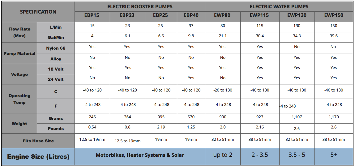

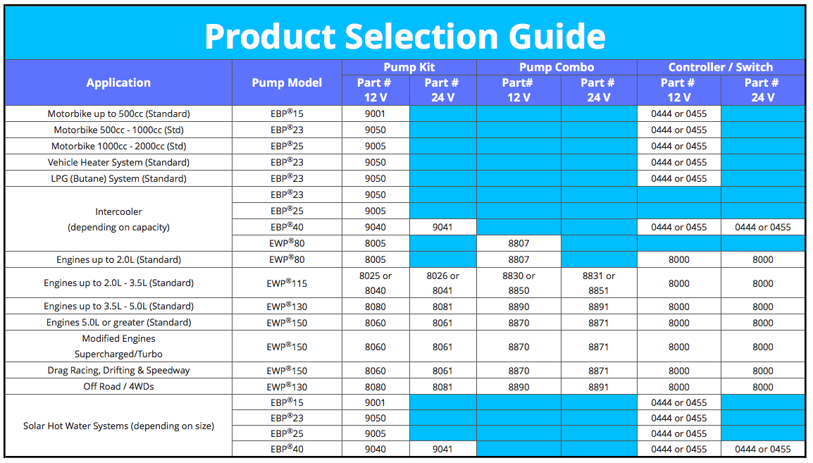

According to this link, I would probably go with the 130 at a minimum.
Davies Craig Reinvents the Electric Water Pump - Hot Rod Network
That seems to confirmed by this page:
Davies Craig Electric Water Pumps (EWP) Information
Attached charts from Craig Davis website say 130 for off-road.
Attached Thumbnails Electric Water Pump Conversion?-screen-shot-2017-03-13-11.32.16-pm.png   Electric Water Pump Conversion?-screen-shot-2017-03-13-11.32.01-pm.png

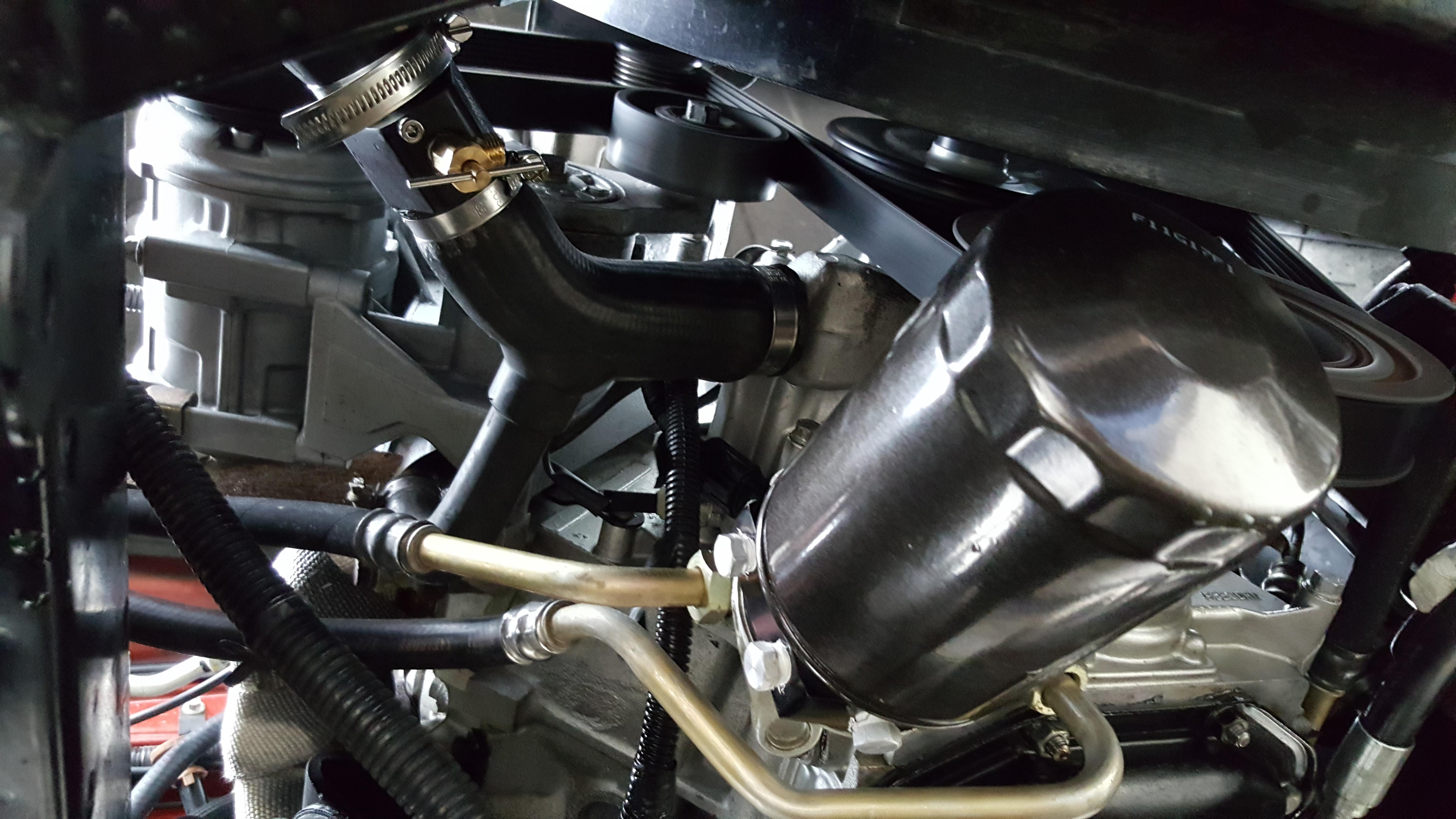

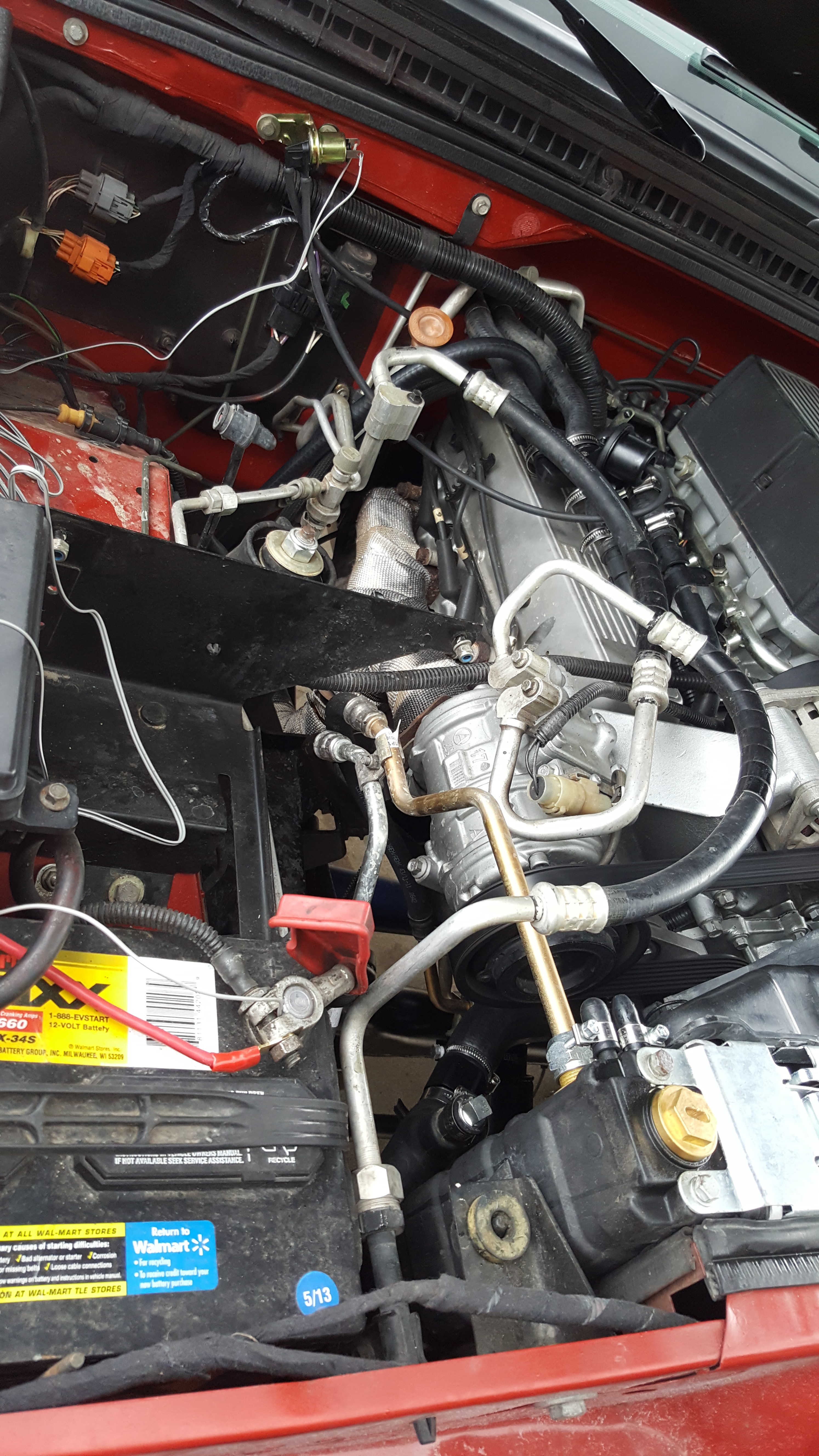

Addressing placement, I do see your point about the booster pump being behind the WYE as it branches off to tank before the mech' WP... will have to think on that 1. Even though I mod'Ed the factory stat out completely, it still leaves the multidirectional fitting so even further mod' may be required. Just move the Wye back to the radiator outlet and the 1.5-inch line to booster to mech WP, then the tank & heater return only need be extended another foot with a couple of barb'ed couplings & everything is back in order. I can appreciate your foresight.
Another idea is to restructure the cooling system by removing the factory reservoir and capping the line that fed it. Then add a radiator spout and cap where the brass plug goes. See pictures for what I did. Not only would it resolve your EWP placement, but it has also reduced my need to "bleed the system" and given me a good system drain. As for temperature effects; I did this in conjunction with a new 180* t-stat and so far haven't seen temps over 186*. However we've only hit low 80s and the true test will come with Texas summers.
