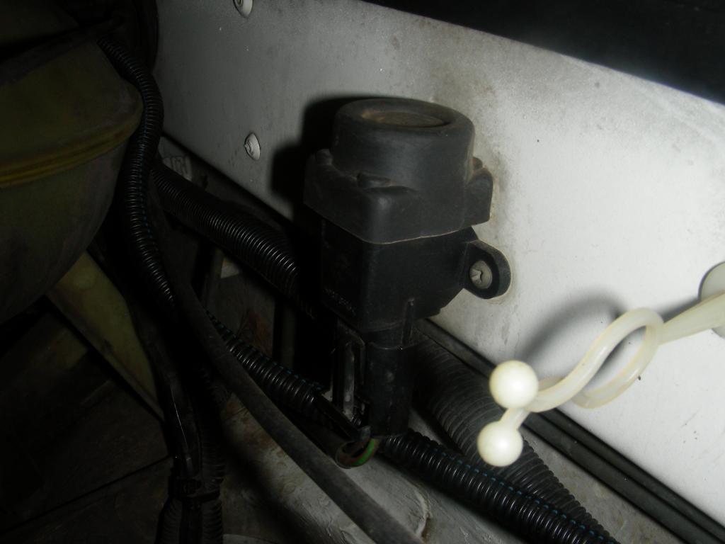

I completed the reassembly of the upper engine today after replacing the head gaskets. Upon re-connecting the battery two things happened: 1) the hazard lights came on without the key in the ignition and would not go off when the switch on the dash was toggled and only stopped when the battery was disconnected; 2) while tightening the positive battery connector with ratchet wrench the handle made contact with the car body by the metal in front of the battery box which made a loud spark large enough to singe the paint and create smoke. I felt no electrical shock at all. At that point, I disconnected the negative battery cable and closed the hood.

Congratulations on your head gasket job.
You may have hit the inertial switch. It is on the passenger side firewall. Try pressing it (down... it is black and round and bolted to the firewall) and if you feel a click everything should be fine.
Otherwise I would guess alarm but you didn't mention the horn.

Probably the inertia switch like Charlie said, I had the same issue earlier this week actually when fixing some rust. When it's tripped, it will throw the hazards on, unlock all the doors, and immobilize the engine.
Back on the firewall next to the strut and the exhaust manifold
