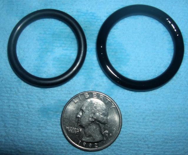

Murphy' Law comes in a multi-volume set. But also consider that main bearings can be done as well, even in the truck. Write up in the tech area. Many ease their problem with rear main leak with Blue Devil / White Shepherd seal conditioner. Here's a pix of how it swells.
