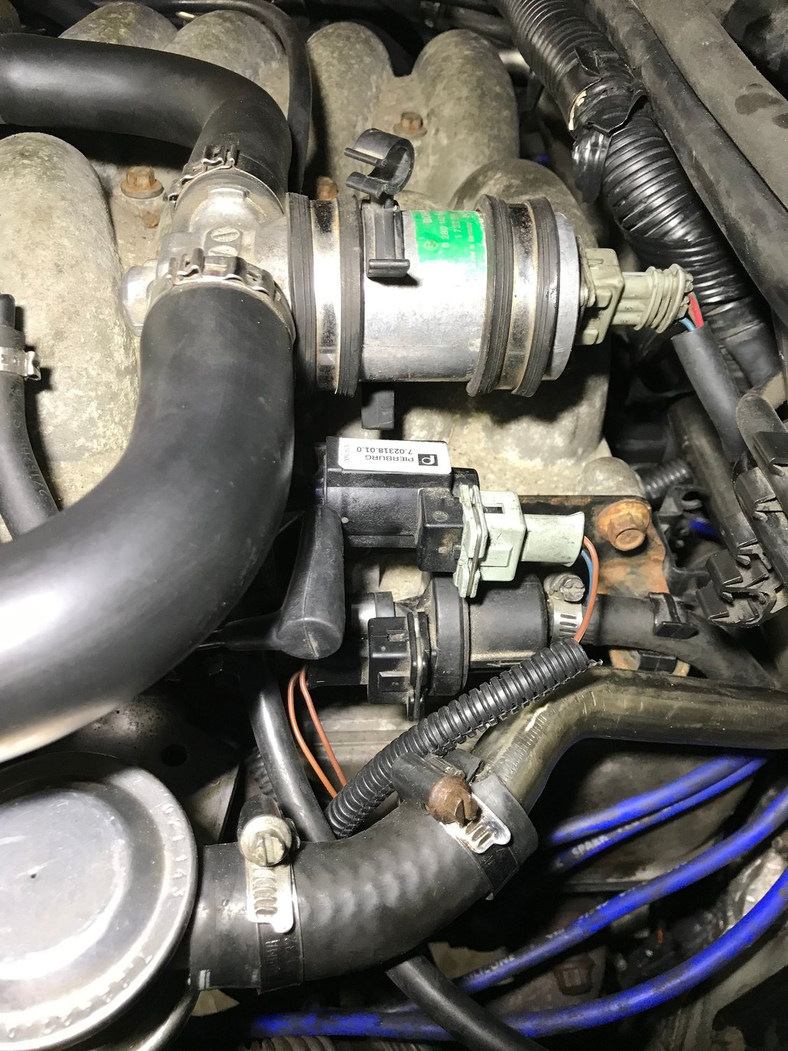

Well it seems you have some great advice! I did seem to have the SAI and Purge Valve connectors switched and I correct that with the photo shown (Wanted to verify). When I unplug the MAF the engine idles but it is extremely rough. It will hold idle better though than when the MAF is not connected. it sputters a lot still though and struggles to stay alive.

I did have the purge valve and SAI valve connectors switched (pic above to verify correct now)! After I switched it back it still had the same issue. I disconnected the mass air flow sensor and it will idle but is very rough. It has problem holding a steady idle and just sounds bad but at least tries. In terms of the lower being mounted on I followed the Atlantic British video to a T and Torqued all the bolts in a spiral pattern starting low and ending at 38ft/lbs.
