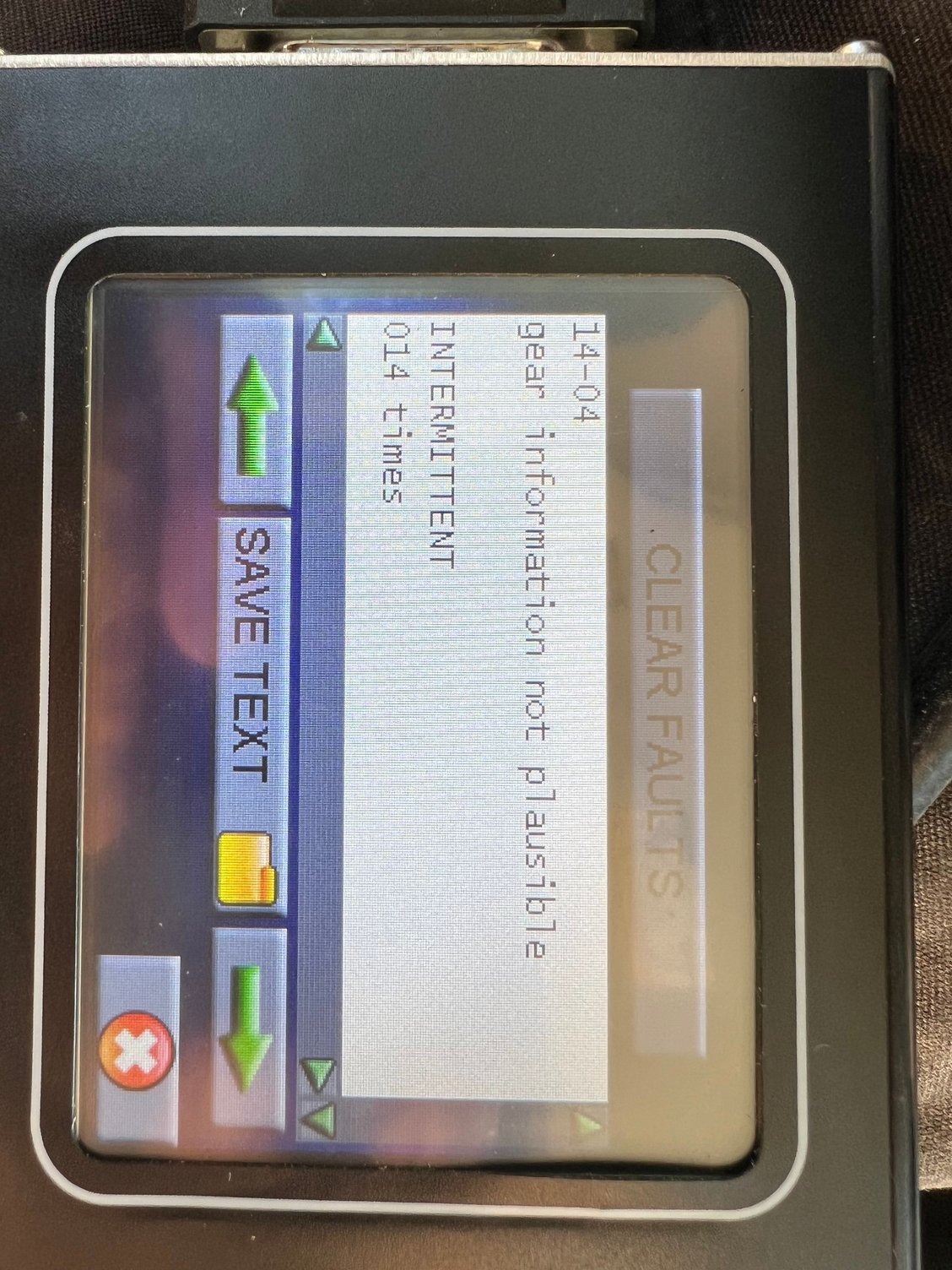

So the nanocom didn’t have much to say apart from this code in the Slabs section.
I can’t find much on this code. Could it have been throwing the M and S?
Everything else seems clear. I have an idle misfire. Am thinking that’s not connected.

So I think I figured out what was going on.
The XYZ switch was throwing a trans code p0705, that was triggering the M and S. (Cleaned the contacts)
When I used the UG to clear the codes, it reset the readiness monitors to Unready, needing the drive 60-70 miles process.
Of course there is the conundrum of how the UG was communicating with the trans when it’s not supposed to. (It wasn’t reading trans codes, just had the ability to knock the M and S lights off)
anyway. P0705 cleared, M and S staying away, readiness monitors satisfied, inspection passed, oil change and trans fluid swap today… awaiting the next issue.
