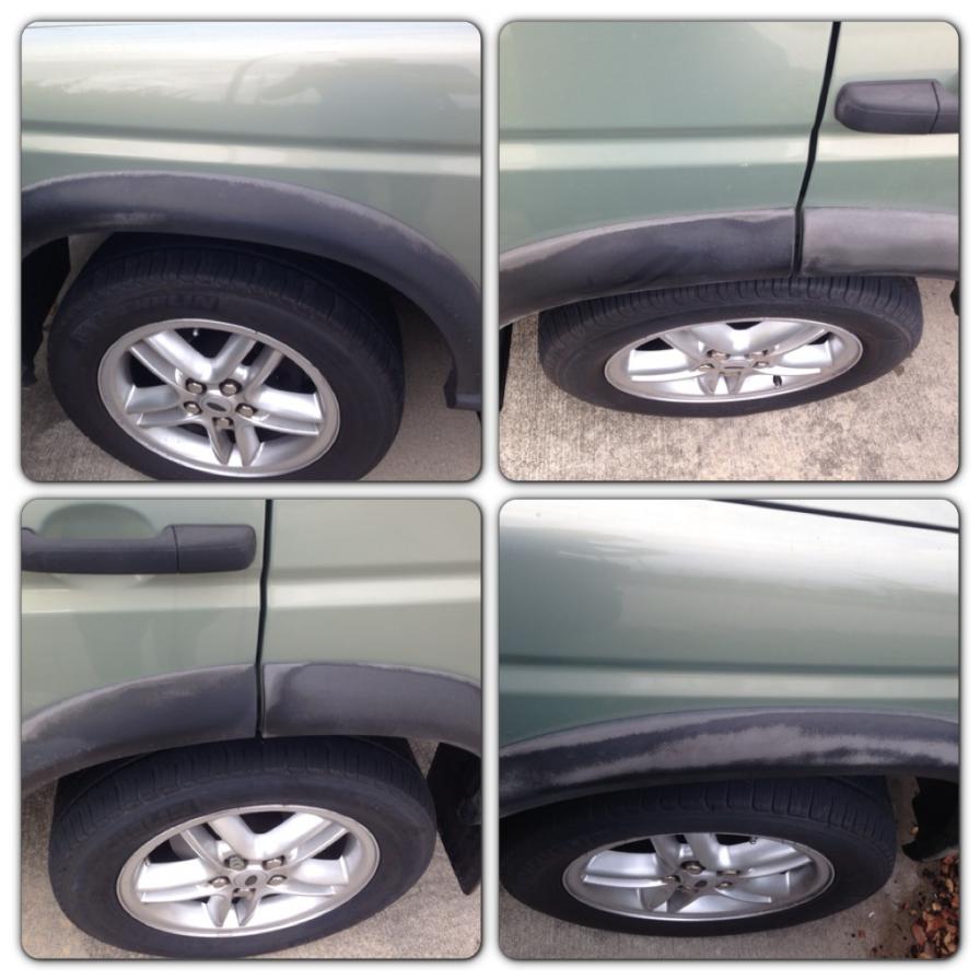

I am getting my fender flares done this weekend for $150. They are coming to my house, doing all prep work and giving me a warranty. Is there anything I should be wary of? To me they are a huge eye sore and I feel so much better having a professinal do them. Here is a pic of what I have now and Saturday I will follow up with the finished product.

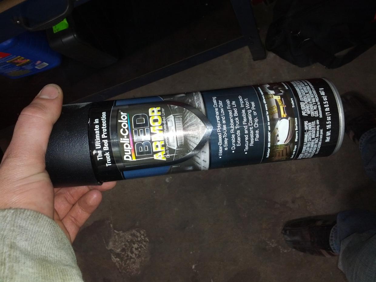

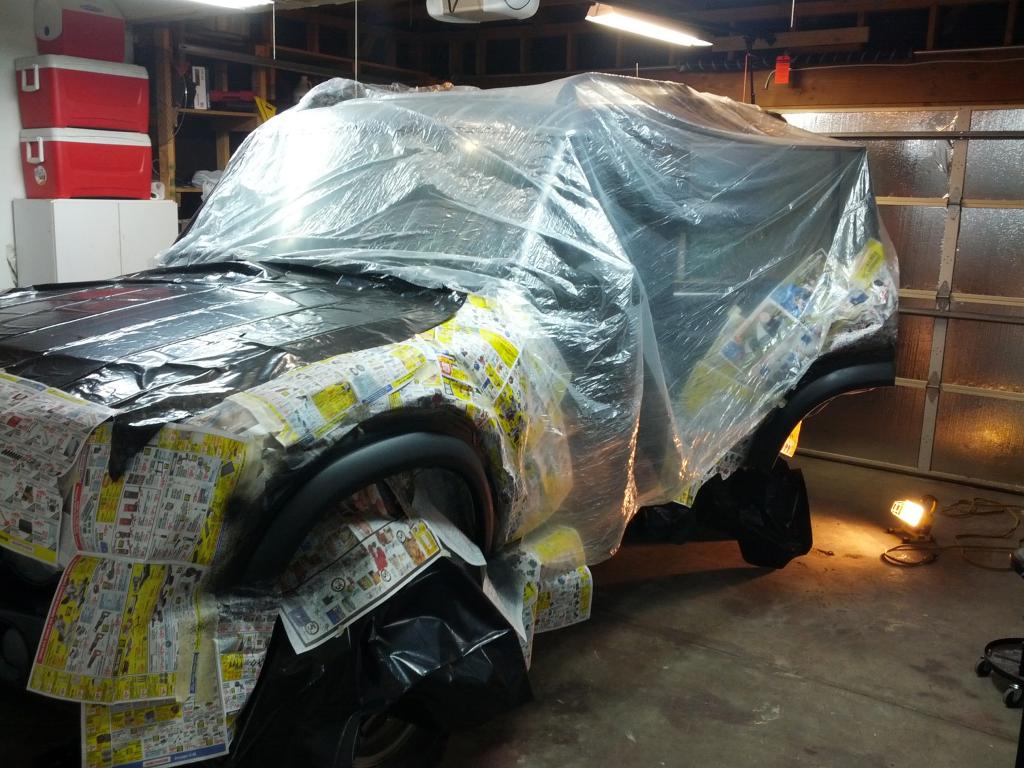

I used Dupli-Color Bed Armor. No sanding required and mine were pitted bad. We spent a half hour sanding the first one and it looks no different than the others we didn't sand.
$20 in paint and a couple of hours.
