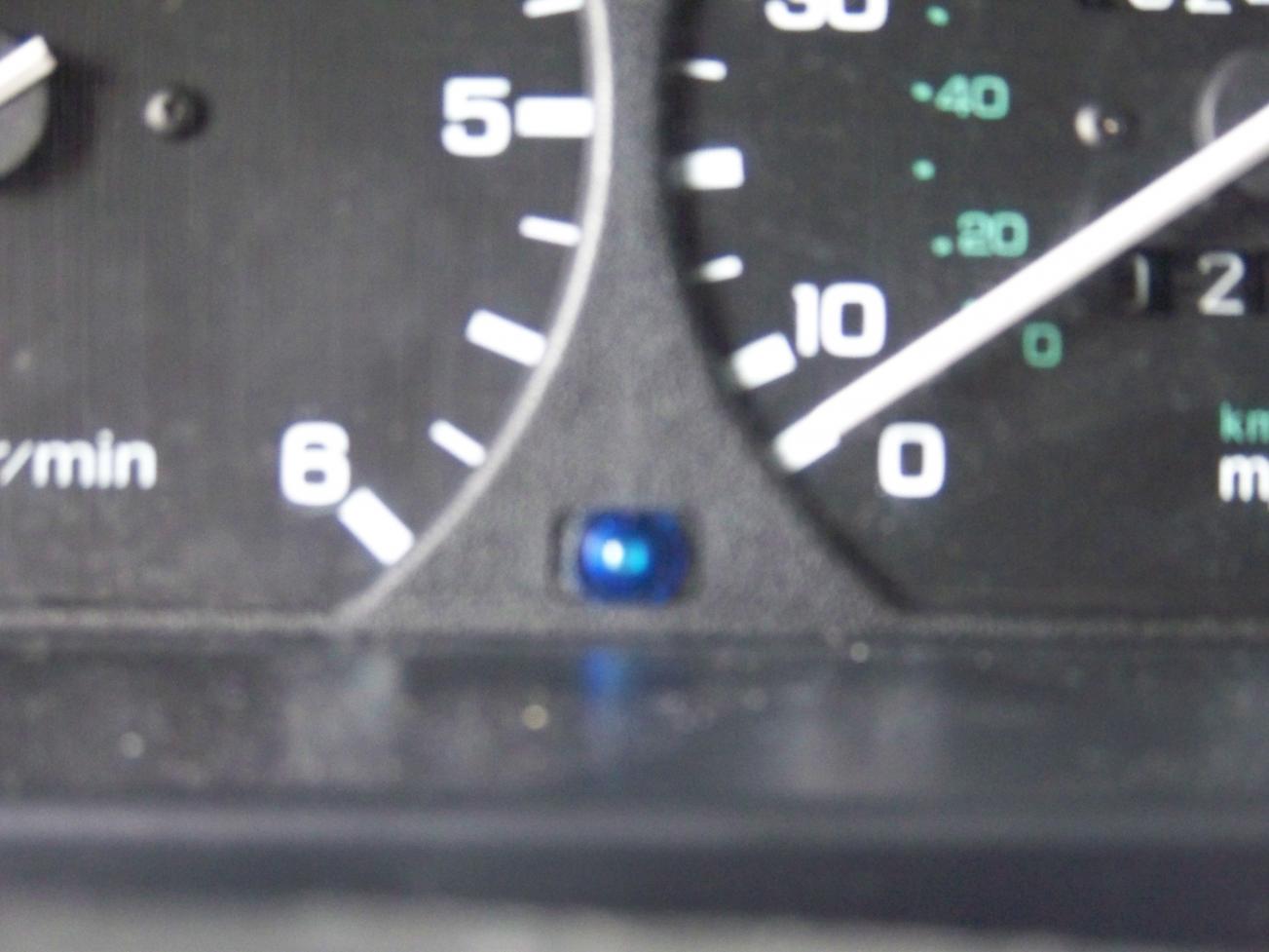

I also replaced my factory security with a 2way alarm/remote start and replaced my red instrument cluster security LED, with the Blue high power LED from my alarm it only took about 30 minutes or so to do.(including the time to remove and reinstall the instrument cluster)
