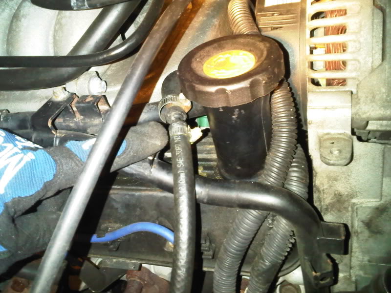

Some additional questions too for the Rover Gods here:
First, any particular coolant to use to top up the system? I will go by what the manual calls for, but figure in the last 11 years maybe others have used something different.
Next, is this line from the coolant tank supposed to have this break/adapter in it? It appears to be fuel line, so I'm guessing it is not original to begin with. This is where one of the leaks is that drips down onto the valve cover. Can I just get a new solid piece without the coupler or whatever that is to replace it, or cut new pieces and keep that in the center?

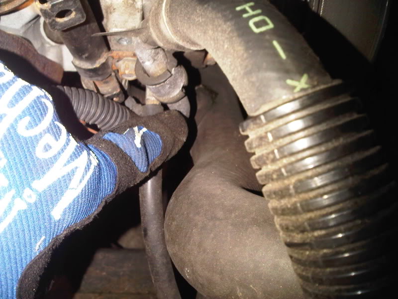

Also, any places to replace the following hose from or anyone buy one recently? You could see where the split is by the joint

Get some heater hose from Napa to replace that leaky joined one, you don't need the join. Don't mix coolants, if you don't know what is in there then flush the coolant and replace with something like Peak. People are replacing the OAT with Peak nowadays, it's a bit like the "which oil is best" debate.

I'll have to do some color matching on the coolant for now and hopefully guess right. I figure I don't want to do a full flush until I take care of all the leaks, but will need to add some. Looks like it had a new radiator so I'm 10 years ahead of the game on buildup at least!
