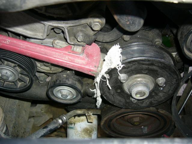

99D2 fan removal, tried several of the methods posted on the various boards and nothing worked... found this solution on Discoweb, but for the life of me I cannot find the post again and I don't want to take credit for someone elses solution. Anyhow, use a small or medium pipe wrench turned 90 to the pully with one jaw inside the hub and the other outside (use a rag to protect the od). Start turning the 36mm nut (ccw facing the front of the Disco) and the pipe wrench will lock the pulley and presto you will get your nut off!
Slick as snot on a brass door ****.

Attached Thumbnails Finally got my nut off!, felt really good!!!-pipe-wrench-pully-2.jpg

Sweet, not a bad method since it works

I wish I had found that a few months ago!! I had to remove the pump with the fan still attached, Effing NIGHTMARE !!!!!
