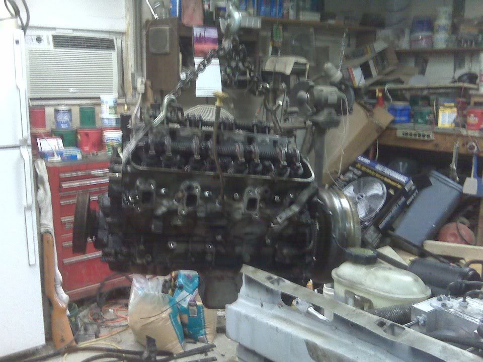

Well, I parked it and started the search for a core - just the core - not an empty block or a full engine - just the core. So after 3 months - I finally found one - for $100!!!!!!! - in St. Louis.
Size:  119.8 KB ('New' Engine from St. Louis)
I high-tailed my a$$ down there as fast as my little 2 door Escort would get em there - spent 6 hours pulling it out of the 'donor Rover' and threw it in the front seat of my car - and headed back to Chicago.

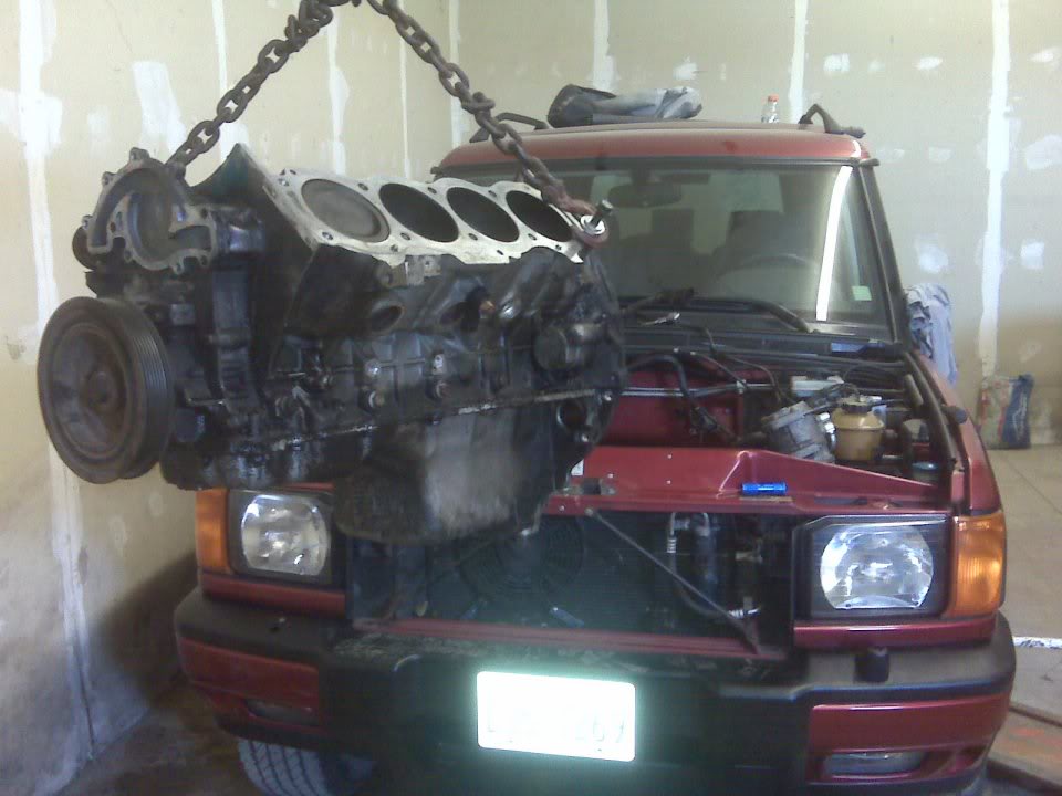

So - I started the chore of pulling apart the old engine to replace it with a 'shiny new' engine.
Size:  72.9 KB (Out with the 'old'!!)

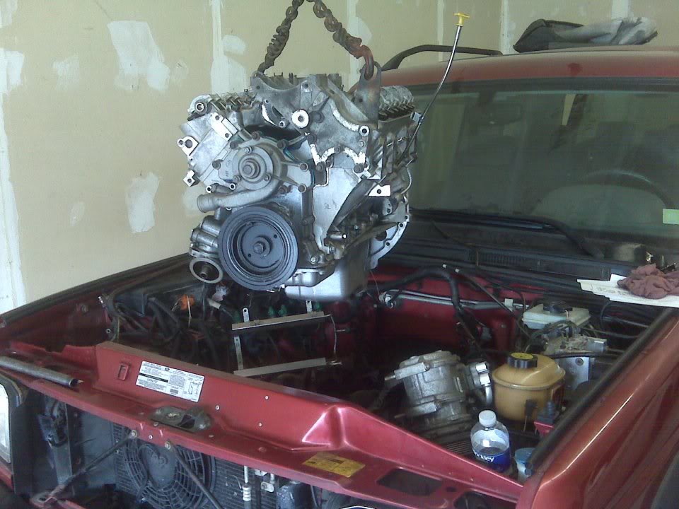

(In with the 'new'!!)
Started up on the first turn of the key!! BUT - found out the gasket behind the timing cover went bad so we had to change it AFTER the engine was in (6 hours later!!) and it ran fine - BUT - we found that the Crank Oil Seal was leaking and that was a 15 minute fix.
