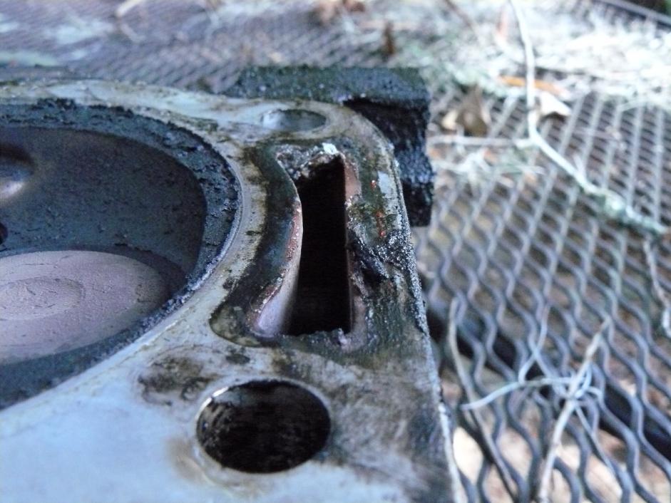

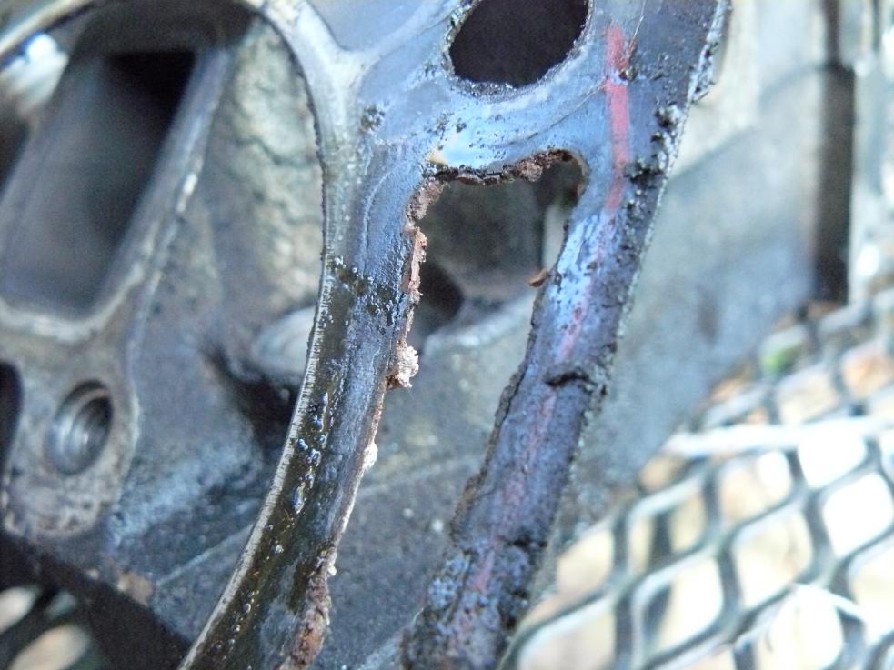

is it common for the head gaskets to leak coolant outward?

HG can leak any fluid (coolant, oil, exhaust gas) in any direction or multiple ones at same time. Also common for valley pan to have loose bolts on rear, and the lip seals to be failed at low point of the valley from tightening the single mounting nut in a vain attempt to seal off oil.
That said, the normal extenal water leak spot is the rear, where gasket covers less real estate around the coolant passage into the head. Leaks along the sides and middle cyclinder require some warp, and in some cases cracked block behind sleeve.
