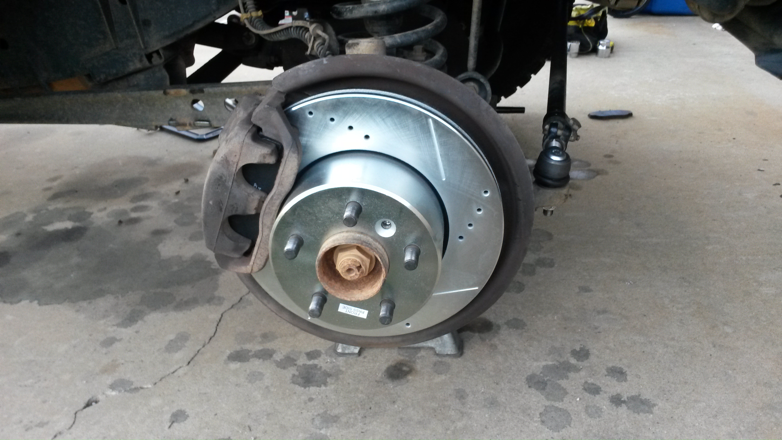

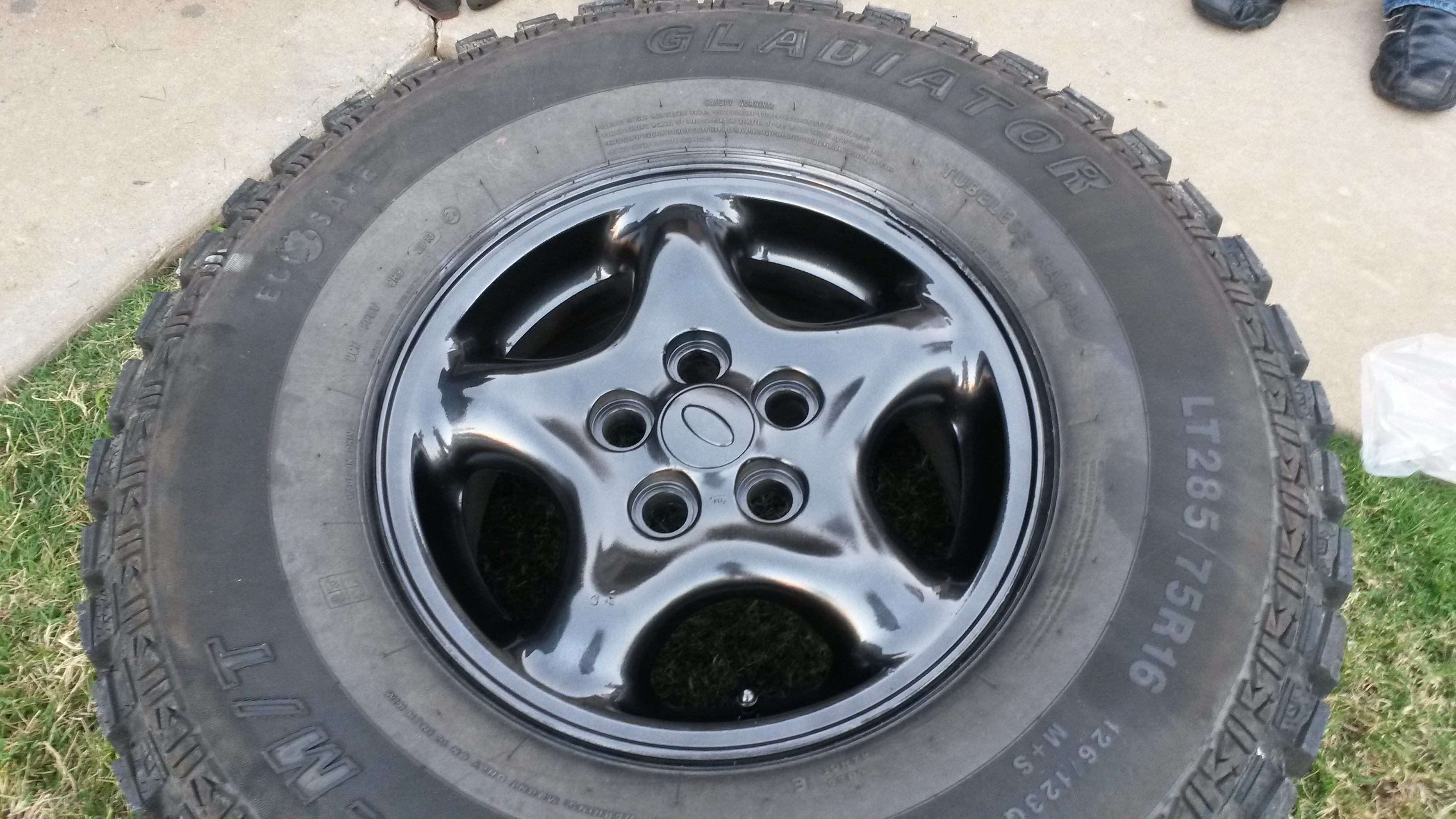

Made some good progress today on the rover.
Got the new brakes installed, replaced the bad wheel speed sensor, painted the roof area that was really faded, and had enough paint left over to hit the wheels with some Niagara Grey. Looks a lot better than the faded black paint that was on them before.
And best of all..... No lights on the dash now! Kinda weird driving it without a Christmas tree lit up on the gauge cluster. Lol

As for the wheel speed sensors, I got those here:
Wheel Speed Sensors
Fast shipping and a good price. I only replaced the one that was dead, but it works great. No problems.
Replacement was easy, as I was replacing brakes at the same time. If you're just replacing the sensor, you do have to pull the brake rotor off to get to it. I used my Autel 619 ($130 on amazon) to read the ABS codes, diagnose the bad wheel sensor, and then reset all of the lights. That tool is WELL worth the price...
The brakes I got here:
Full brake replacement set
And I have nothing but good things to say about them. They bedded in great, and are very confidence inspiring on the rover. Smooth and strong. I've had great luck with using those brakes on cars (as have many others I know), and I can now say that they work well on the rover too.
As for painting the wheels, it was really straight forward. I didn't even tape anything off... Lol
Just be careful around the outer edge of the wheel rim so you don't cover your tire. I wiped the wheels down first with a clean rag and some brake cleaner before spraying.
No problems removing any of the caliper bolts, or the caliper bracket bolts. They all came right off with a 3/8" ratchet.
I had more problems with those dang lug nuts and their stupid caps than I did with anything else. Really wish I could find some aftermarket lug nuts to replace them all with!
Oh, and the brake rotors were a pain to remove from the hub. Had to use a BIG hammer and beat on the old ones to break the rust/corrosion seal that had built up where the rotor meets the hub...

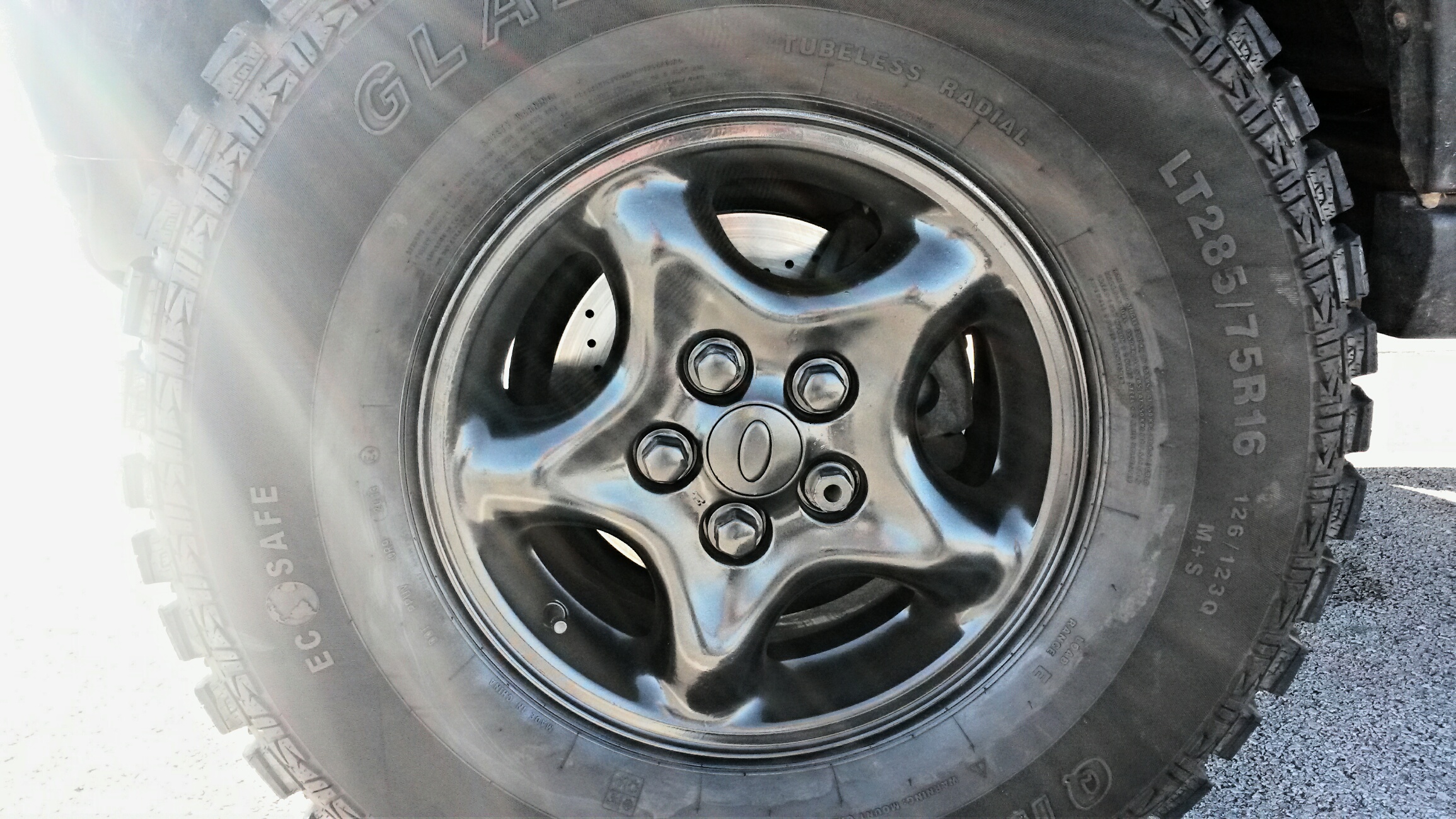

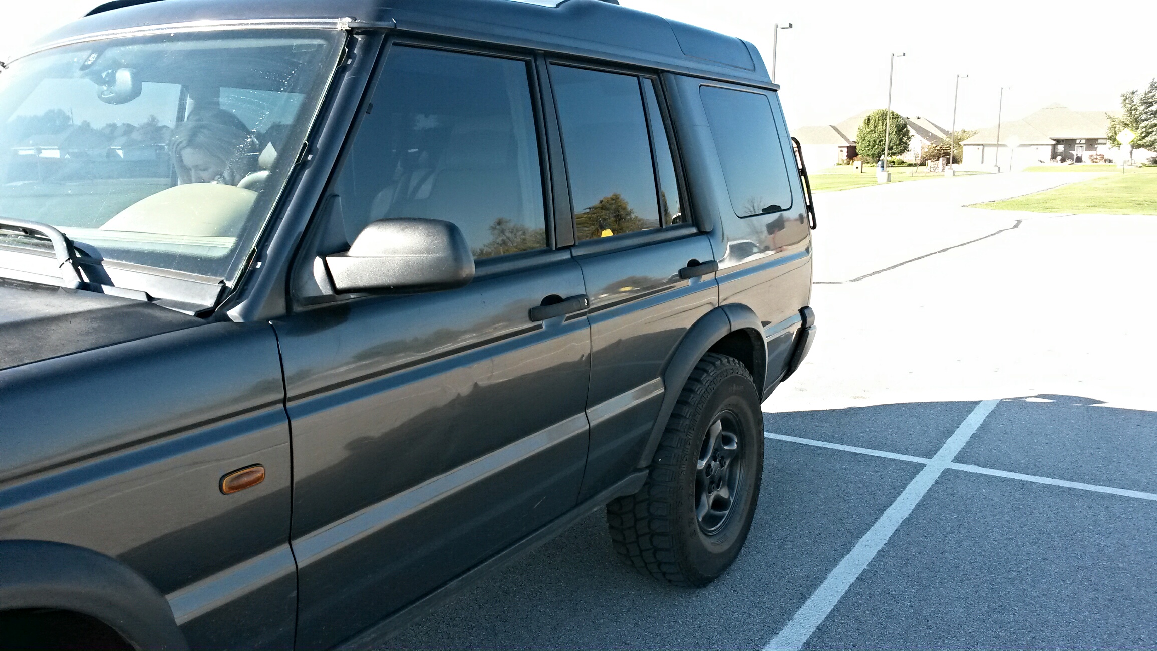

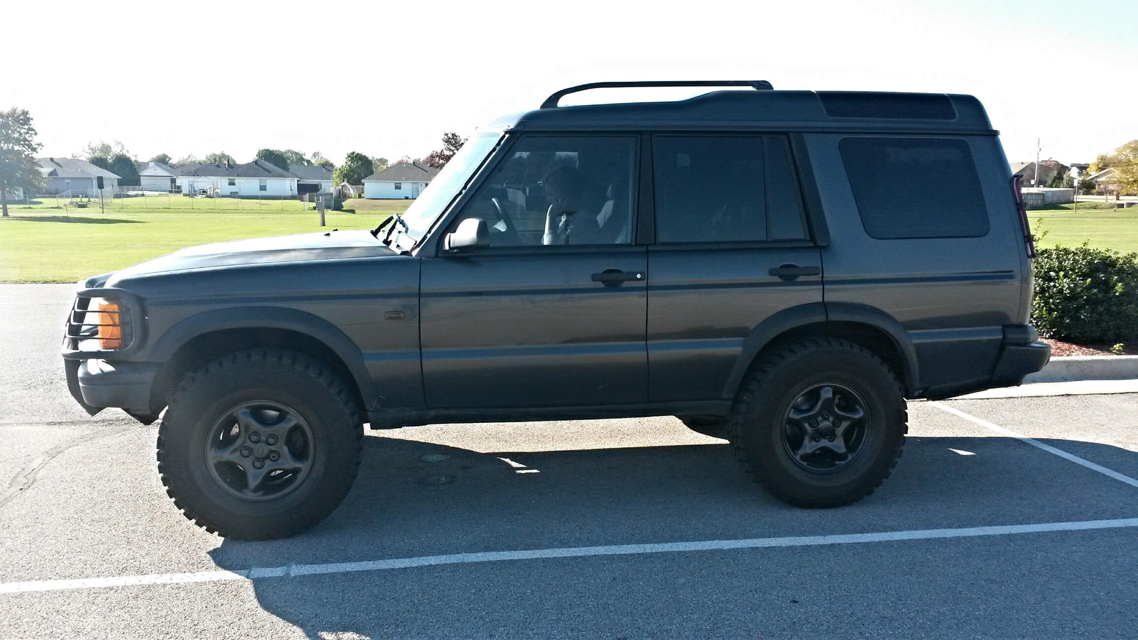

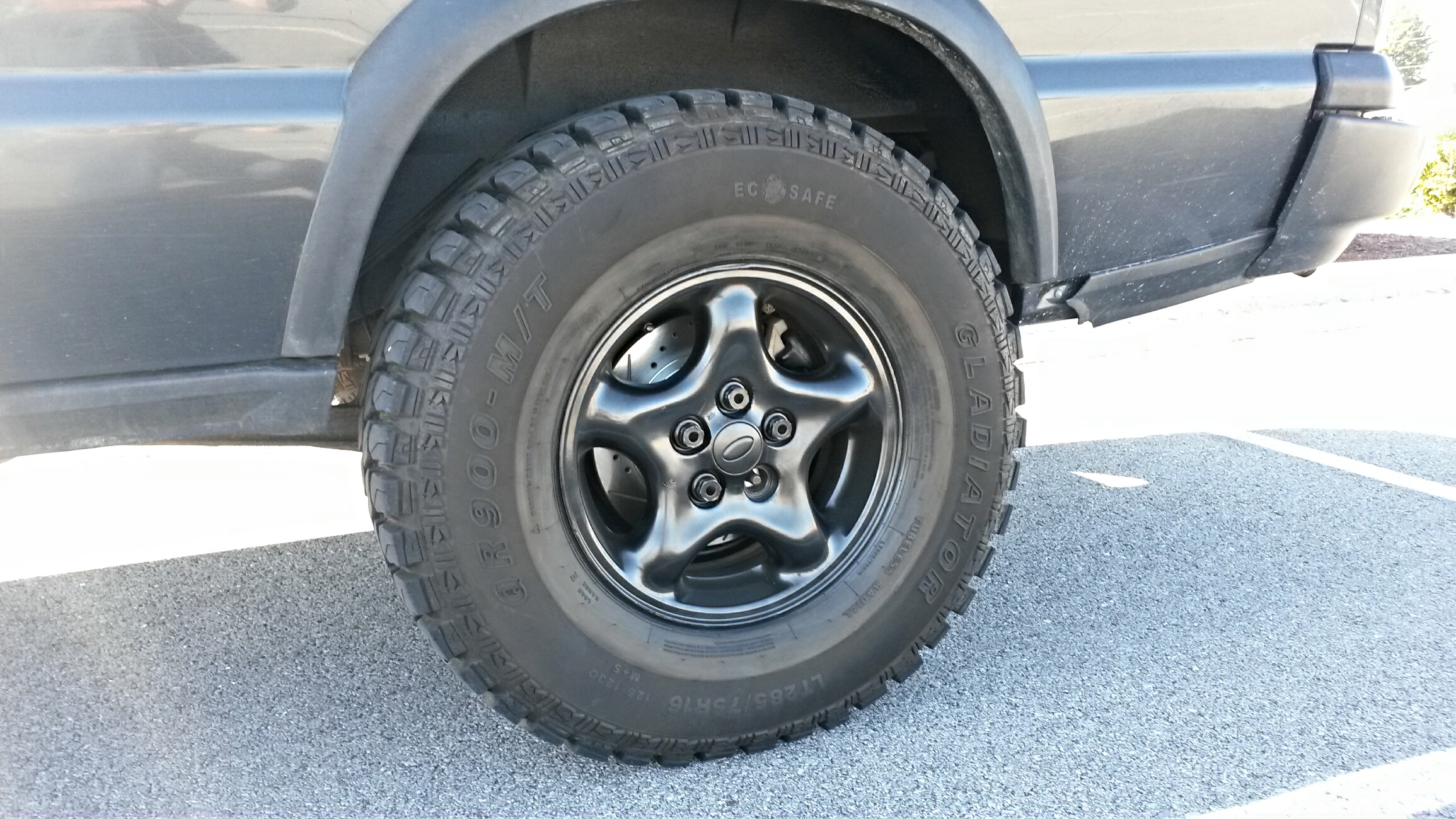

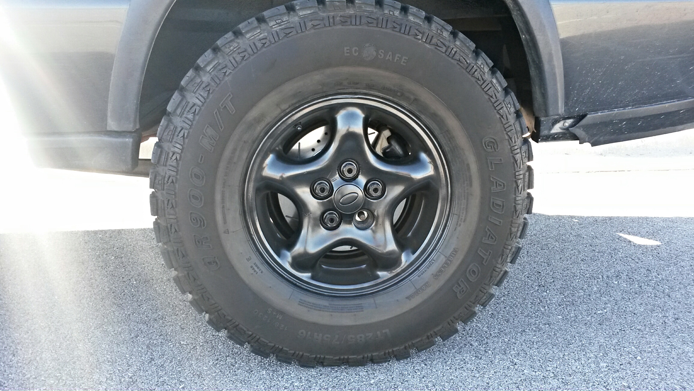

Here are a few camera phone pics I snapped today. The wheels look pretty good, and the brakes look great on there.
