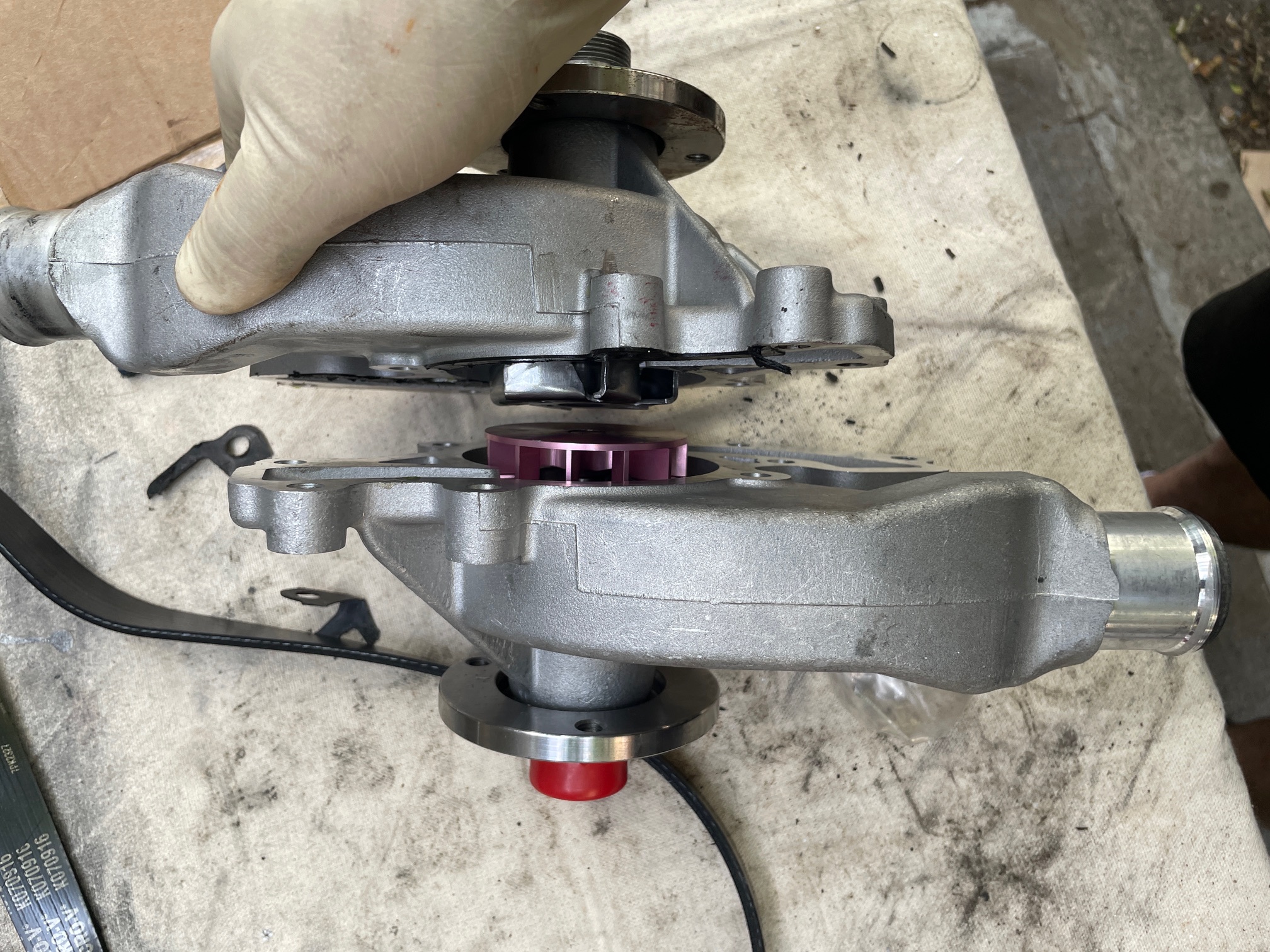

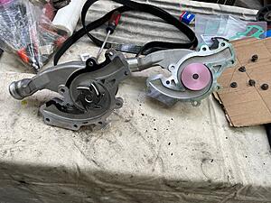

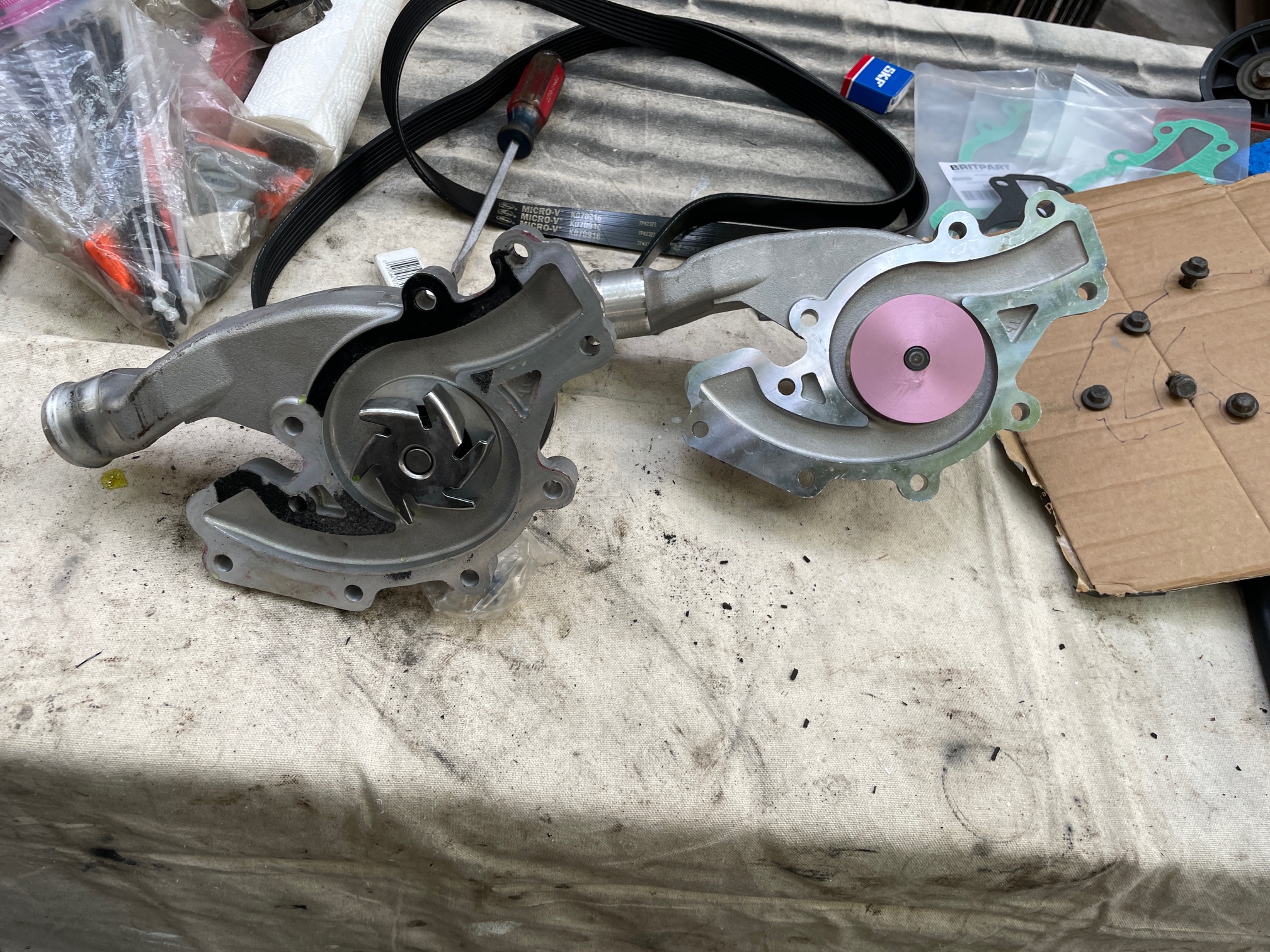

I just installed one in the P38 and will do so on my D1 as well. Quality seems to be good.
The 'regular' unit pictured is a $40 item from Amazon.
Attached Thumbnails Flowkooler Water Pumps-img_1102.jpg   Flowkooler Water Pumps-img_1103.jpg

Just noting that the FlowKooler comes with a gasket. I didn't see that mentioned anywhere when I ordered it, so I have a spare now.
