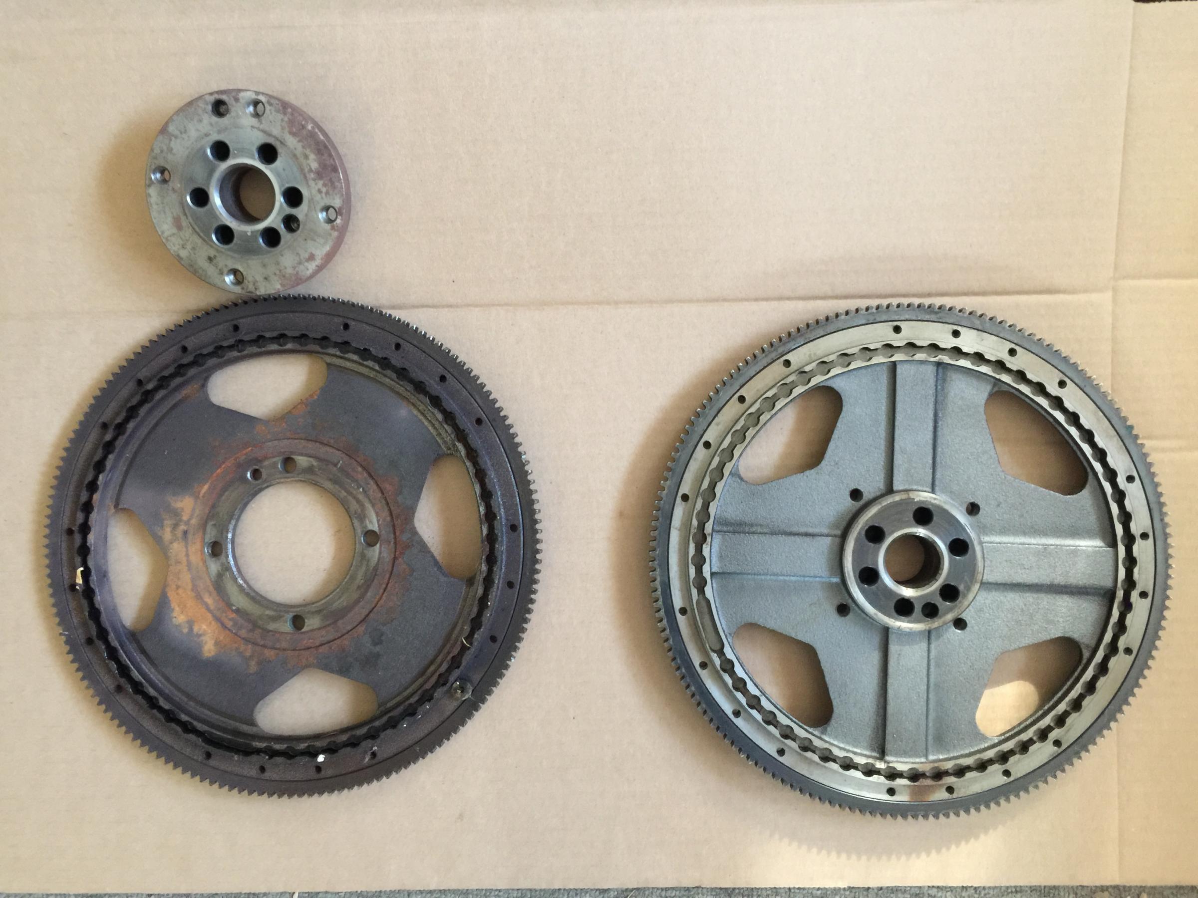

There are differences in the gear ring. I'll post up pictures if I get a chance. They are, ultimately, interchangeable.

Okay, you have one ring gear, the one on the left with a part number of HRC2932. I seem to recall this coming out of a 4.0L. The one on the right is TPD000050 which came out of a 4.6L. The one on the left comes in pieces whereas the one on the right is a single unit. Parrt number TPD000040 also is valid for the ring gear. The flex plate will work with any of these units.
