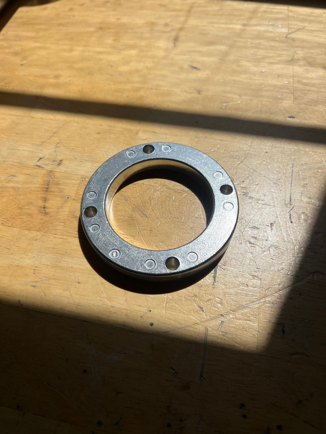

Do you use the 1/2” spacer that comes with the Dorman fan?
Thanks!
Old May 31, 2025 | 01:50 PM
Best4x4's Avatar
Posts: 7,985
Likes: 2,497
From: Beaumont, TX
No you do not use that
Thanks!
Been running it al day. Haven’t really noticed a difference. Newish radiator, 180 in-line T stat, Koolfow pump. Typically runs between 183 to 190. So far, pretty much the same.
