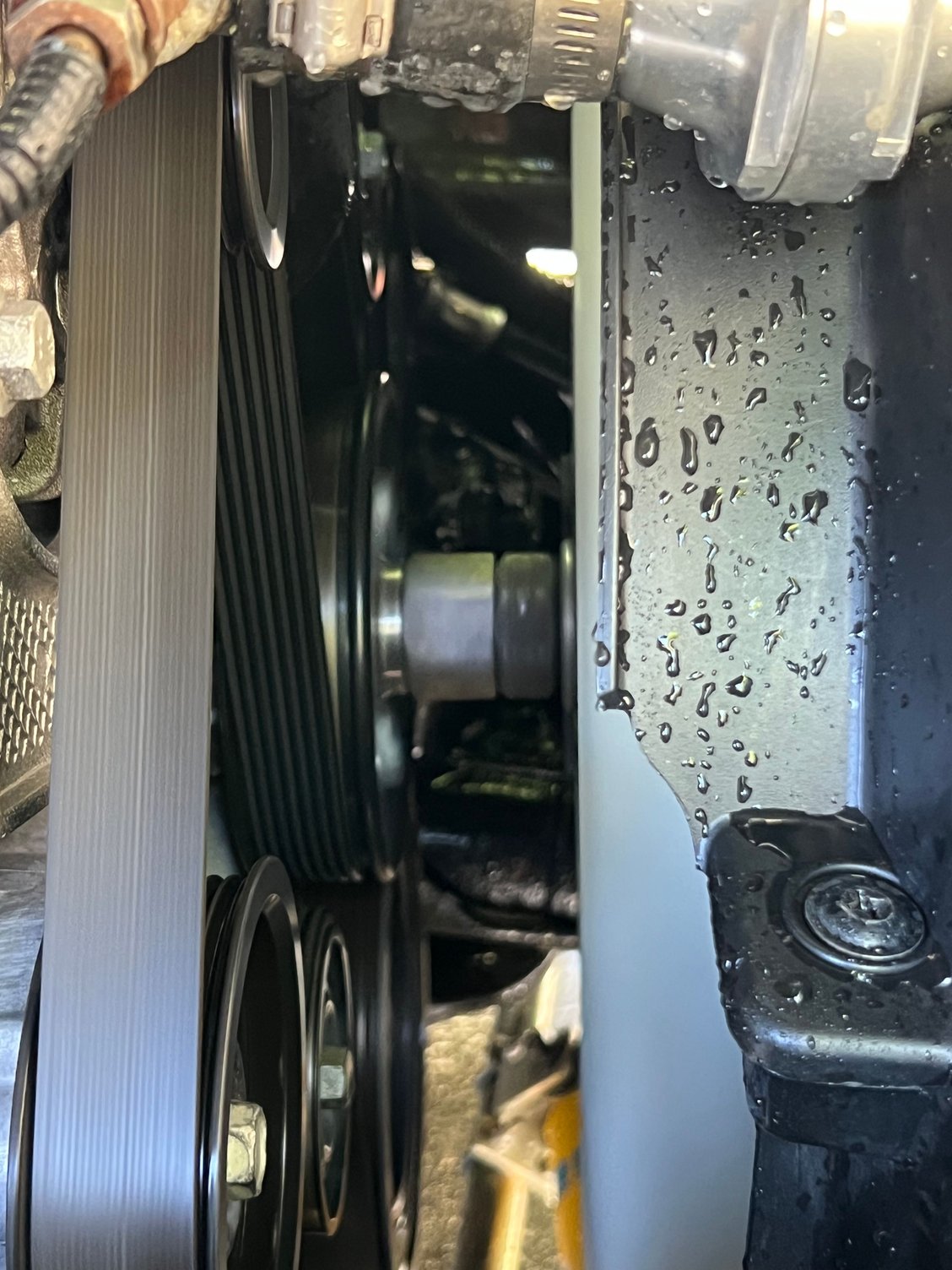

Originally Posted by Tony Luna
Thanks!
Been running it al day. Haven’t really noticed a difference. Newish radiator, 180 in-line T stat, Koolfow pump. Typically runs between 183 to 190. So far, pretty much the same.
Ordered one of these to push the Explorer fan about an inch closer to the radiator.
Old Jun 28, 2025 | 05:23 PM
Tony Luna's Avatar
Joined: Aug 2012
Posts: 645
Likes: 258
From: San Mateo, CA
I’ll see if this makes a difference.
