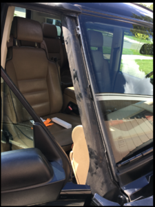

If you have to repair the gutter, it's a must to remove the pillar. Just be careful and buy some rivets on eBay.

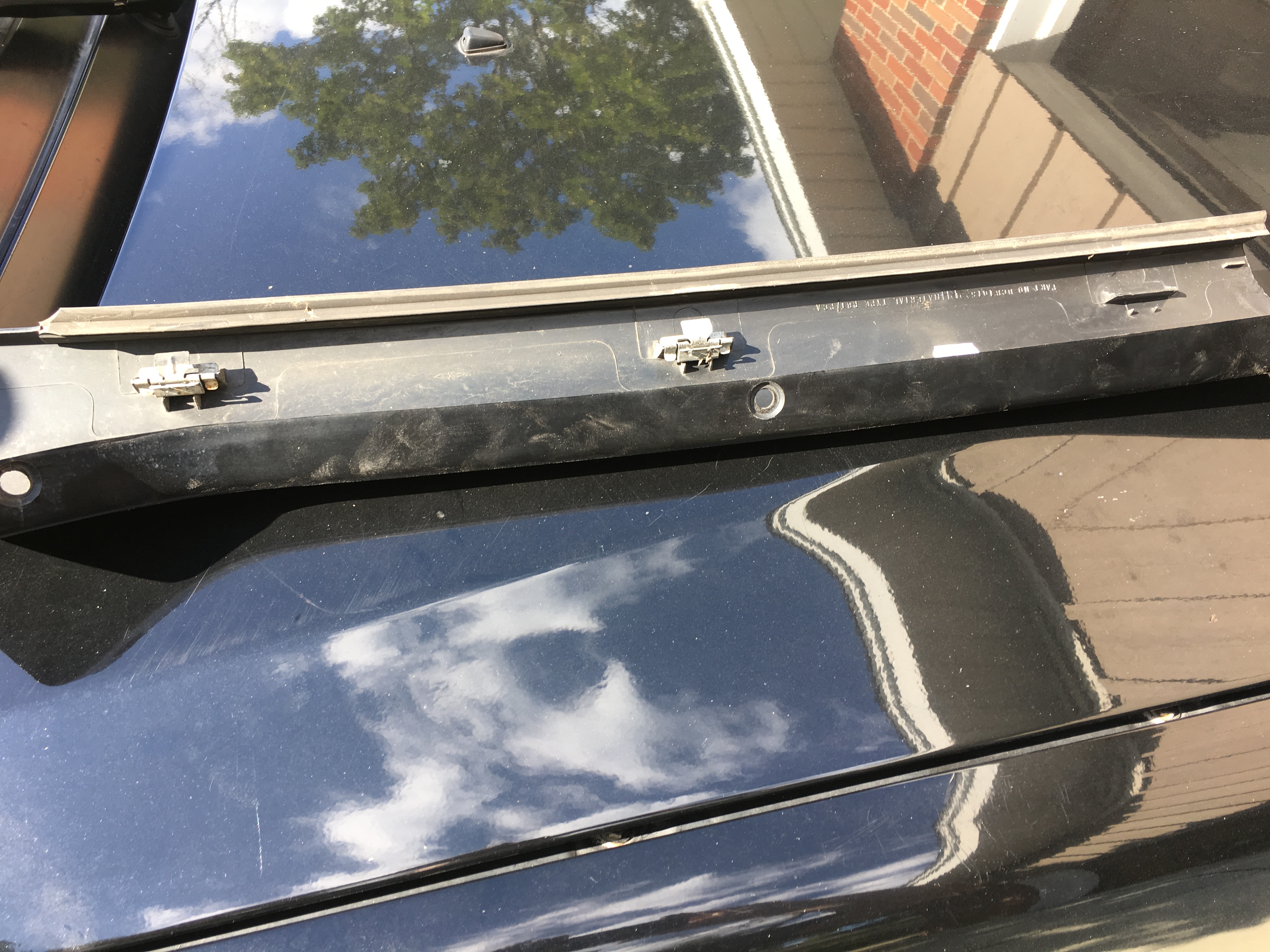

Watch the Atlantic Brit video. But after you pull it off, the metal clips stick to the pillar. You need to gently remove them and put them back on the plastic peice. Then snapped it back on. Add rivets to secure.
