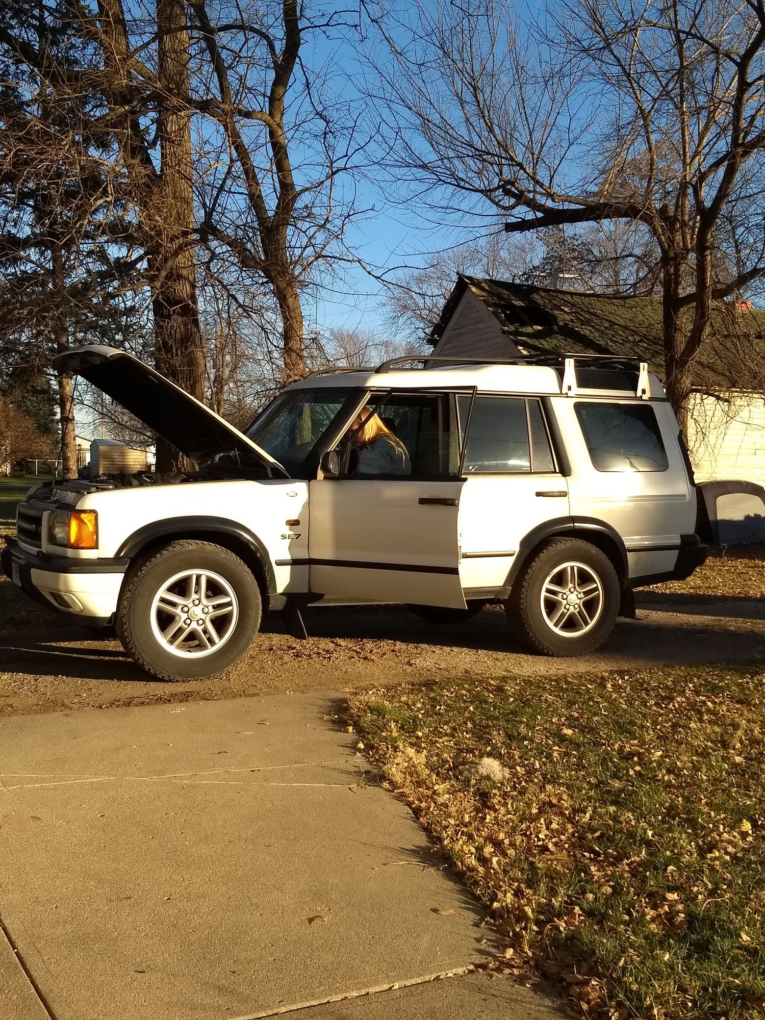

My daughter busted up her front on something. Long story short is I have to get an aftermarket bumper and drive 10 hours to denver to get it mounted. I will have to do this job with tools and material that I take out and install in a snow covered parking lot so I have a few questions.
1. What bumper to buy in the $600 range that will fit up without problems. She doesn't need winch mounts or bull bars.
2. What do I need to relocate the washer bottle? Is there a different washer bottle that works better?
3. What to do with the inner fender skirts that go over the front tires. To you just trim them and secure to the new bumper.
4. Are there other things that need to be done.
The truck is a white 02. Thanks for any suggestions.
