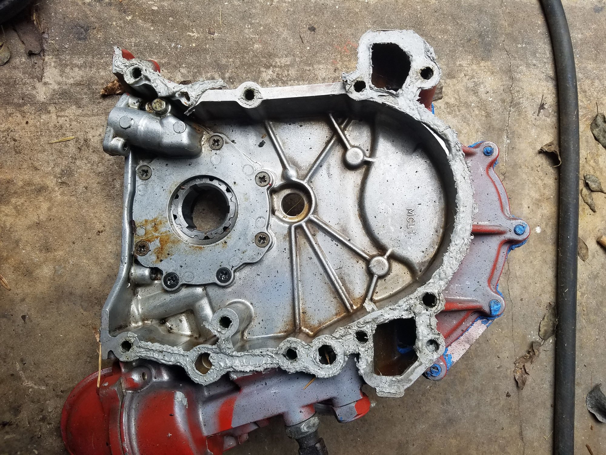

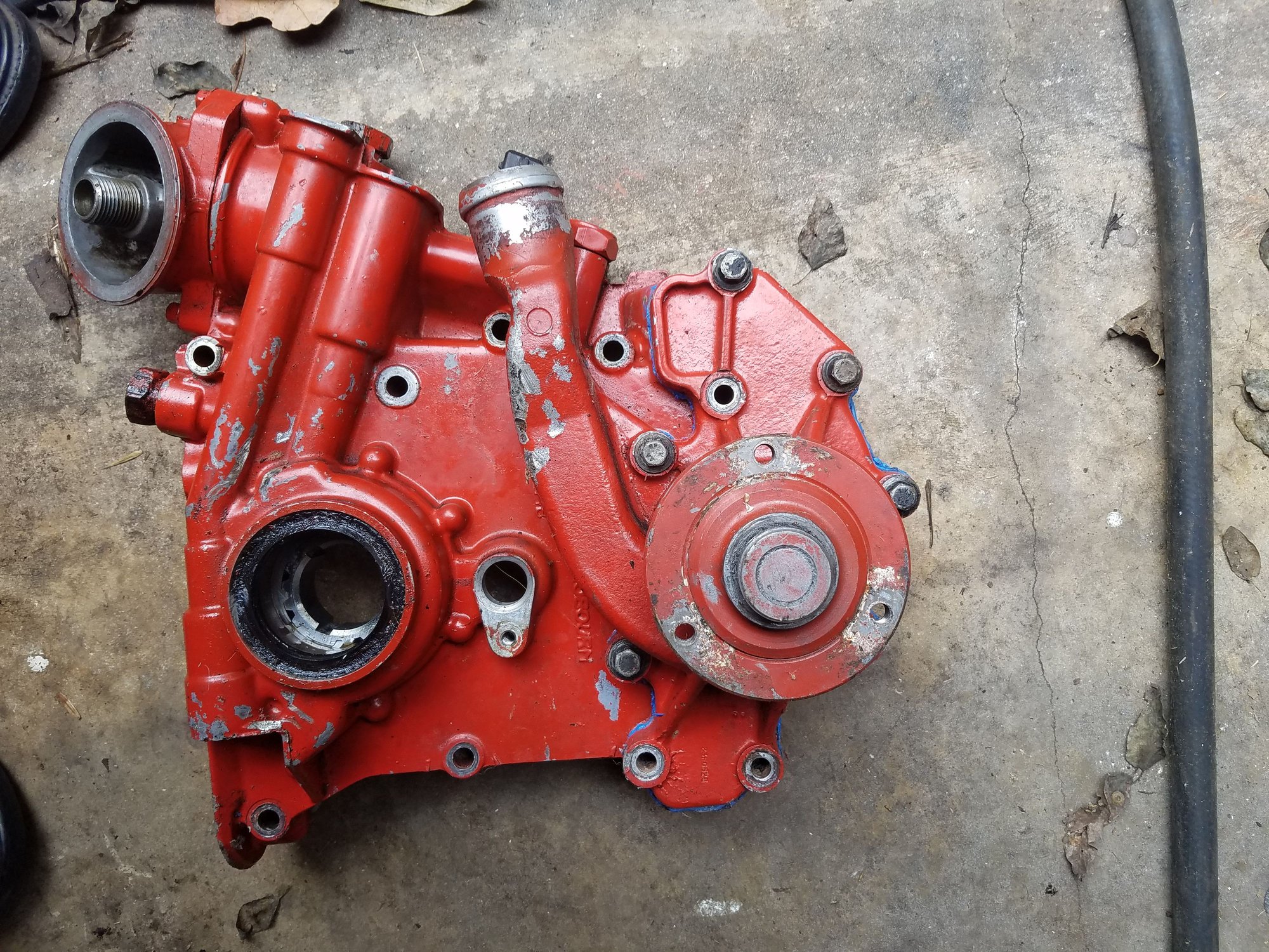

The front cover meets the pump, of course, but it isn't above it. See pictures.
If the leak is above the water pump it is probably head gasjetgasket, heater line, thrbody body/hose temperature sensor, or the main return for coolant (big pipe in the middle).

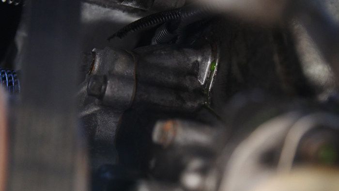

Looking at the back of the cover you show, my leak is at the top large water way on your 2nd photo.
I managed to get a decent photo.
Interestingly, I ran the engine for a while for it to get hot, expecting it to get worse, and it has almost stopped.
I've wiped it clean and am letting it cool over night seeing if its linked to some kind of hot/cold expansion. If so, I would expect to see more evidence of leakage in the morning. If so, I might try simply torquing the bolts.
Linked to that, When I installed my water pump a few months ago, there is a chance I havn't torqued the bolts enough at that time, as I think some of them go right through the front cover, and actively hold both items?

It took me a little while to sort out and match up your photo with the two in Charlie's post, but I see now what you mean.
Seems to me it'd be worth your while to double-check the torque on that and the other water pump bolts, but remember the spec is only 18 lb.-ft. Unfortunately even if that was the cause it may be that it's now too late and the front cover gasket will need to be replaced regardless. But as I said re-torquing the water pump bolts would be worth a try. Good luck.

Ha. yes, I can see how that might be a bit cryptic looking. It was an odd angle to get a photo. I should have taken a wider one for context. I tried to find the relevant schematic type drawing to put a red arrow on, but couldn't see one.
Im waiting as it cools down tonight, to see if its a temp variant thing. I feel it might leak more when cold. Which gives me hope for a bolt-tighten. But I know what you mean, if its started to weep, stopping it will now be unlikely.
I didnt torque the bolts properly on the water pump, just knowing they wernt that high, gave them what i thought. If that turns out to be a mistake.......
