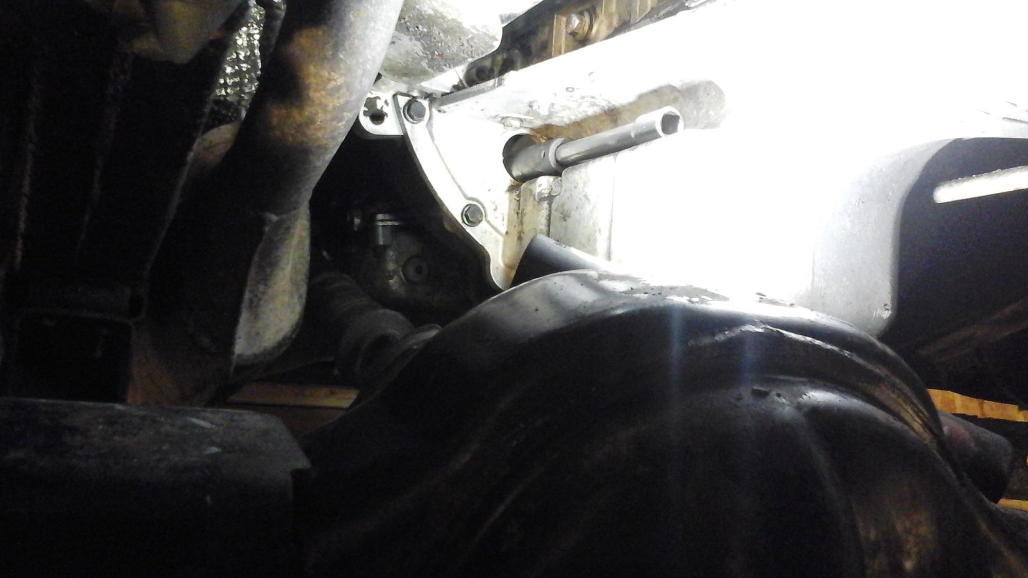

I lock the flywheel by removing rubber access plug to flexplate bolts, turn engine until a round flexplate opening appears through hole and install a 20mm deepwell socket on an extension. This way, it can be done solo and from the front of vehicle.

Thanks for the tip. I will try that next time, hopefully not anytime soon . The crowbar method works solo too, I just jam it somehow in by resting the other end of the crowbar onto the crossmember.

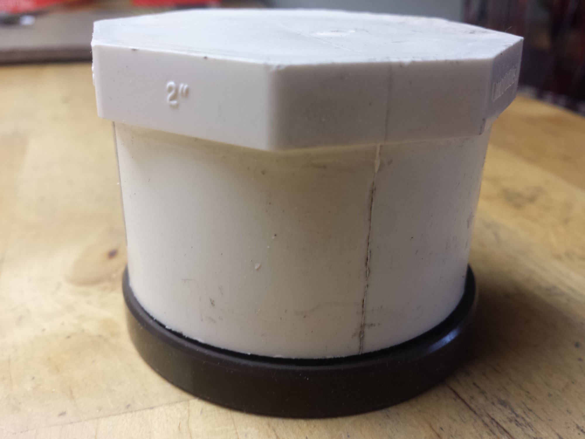

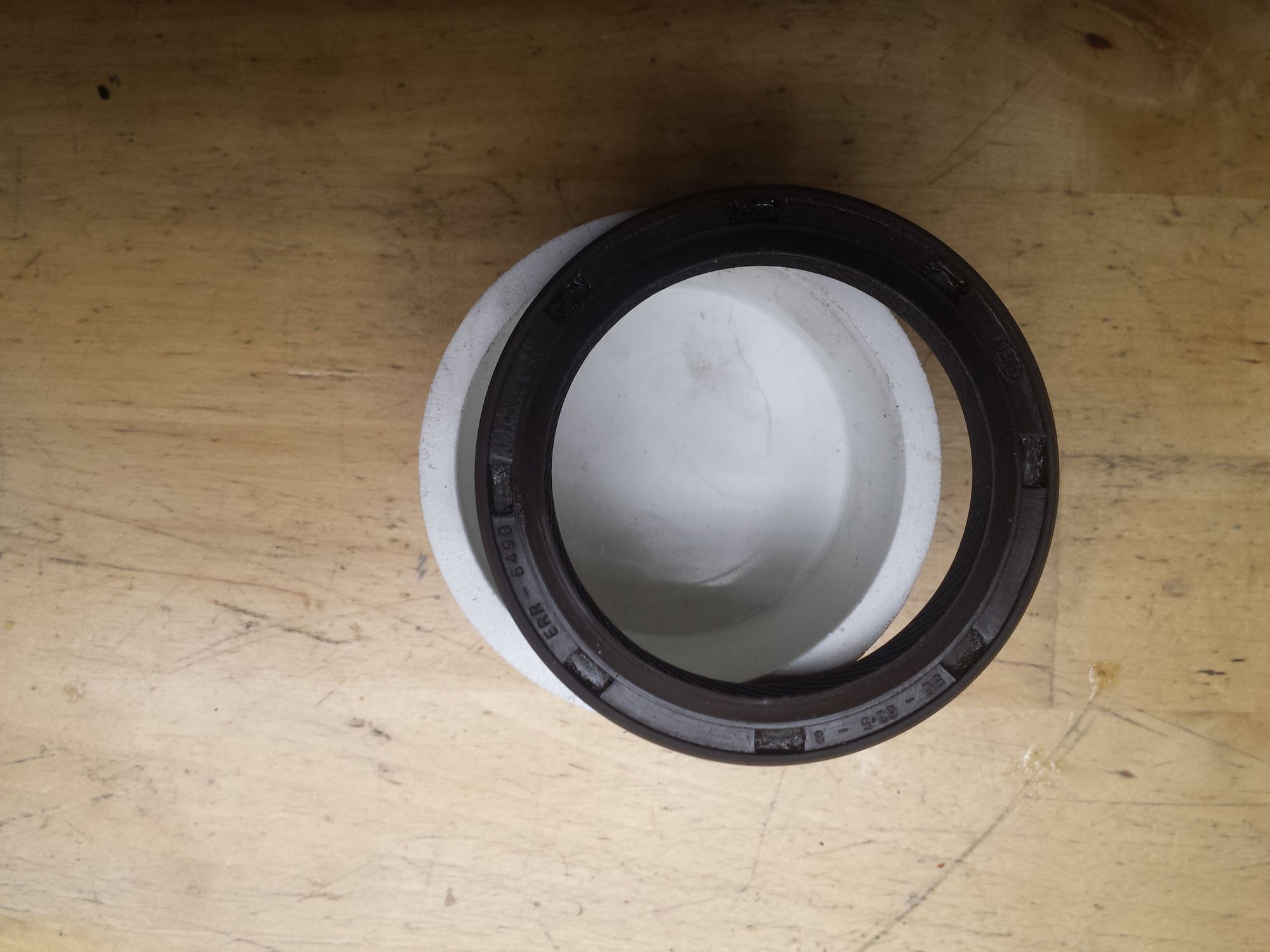

Here is how I pushed the seal in instead of using a socket. I got an end plug for 2" PVC pipes ($2.55 hardware store).
