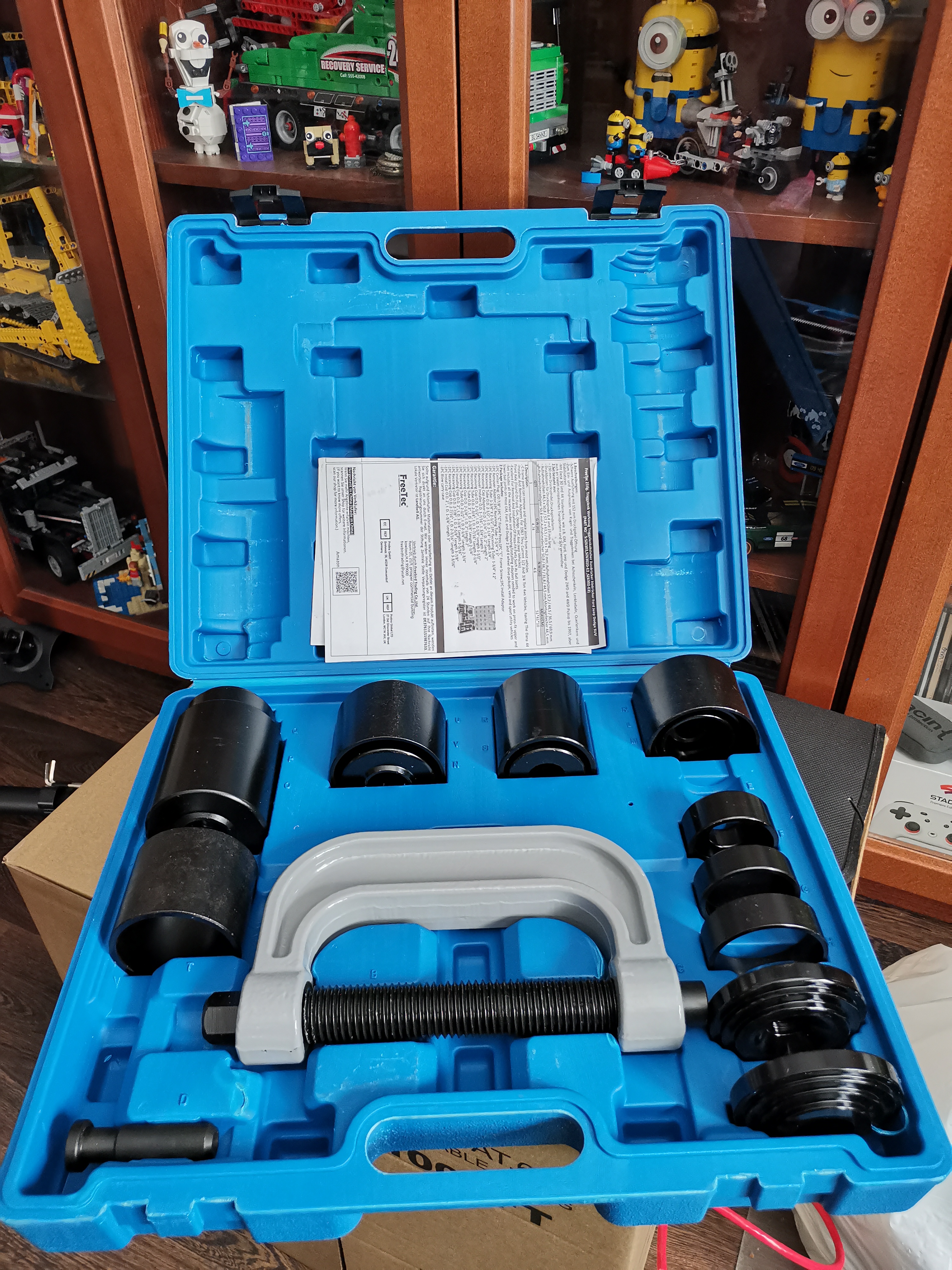

Rebuilding the front prop ain't too bad with proper tools like the c clamp, and doing it in the correct order to get the double cardan put back together.
And do get proper uj's and not any britpart crap.
I rebuilt mine few months back when it failed and before I got a new wide angle one.
