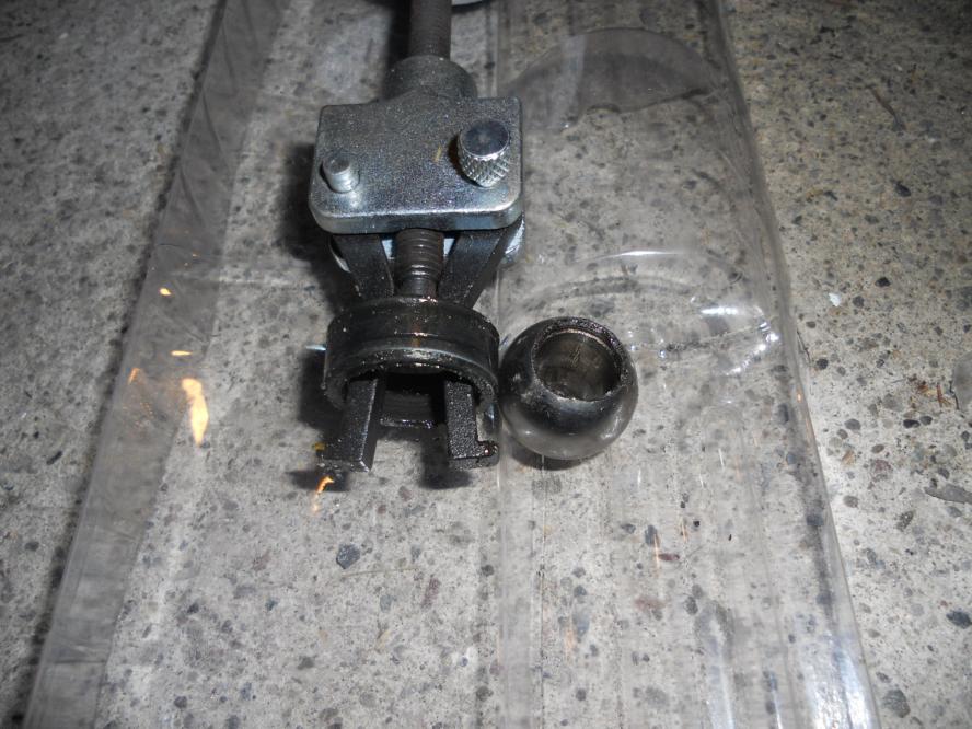

i didnt get a pic of the broken off part of the ball... i might have tossed it... if i find i'll photo and post here's the broken ball removed with the sleeve and the slide hammer attachment used for both
Attached Thumbnails Front Propshaft driveshaft double cardan ball cv rebuild notes-dscn2041.jpg
