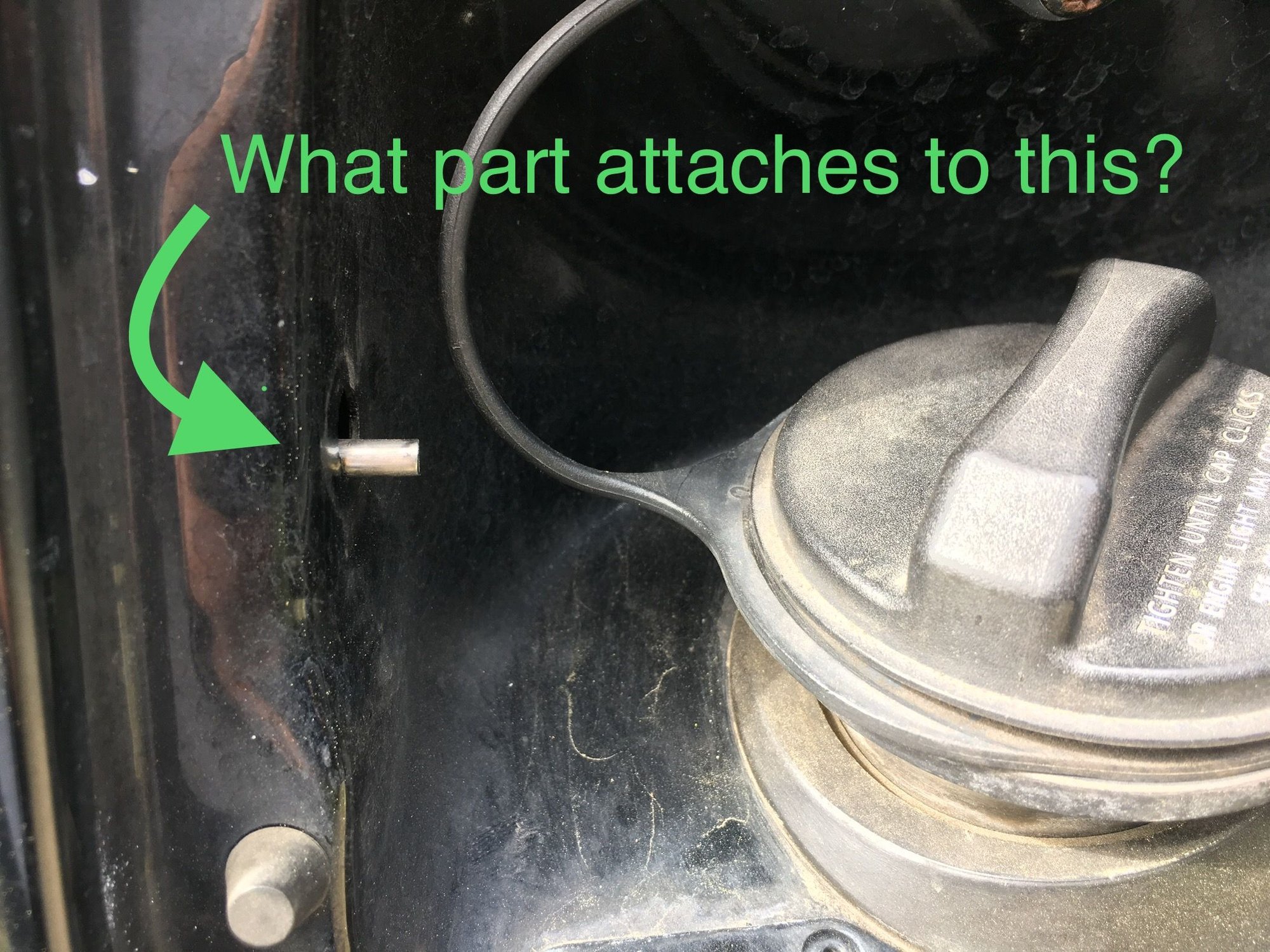

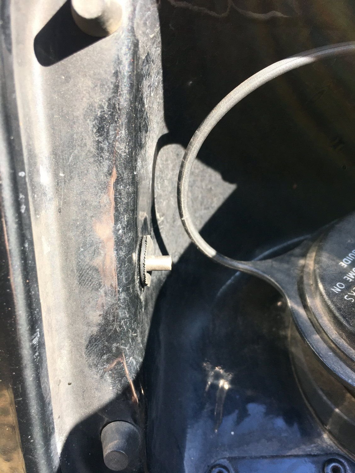

Hi,

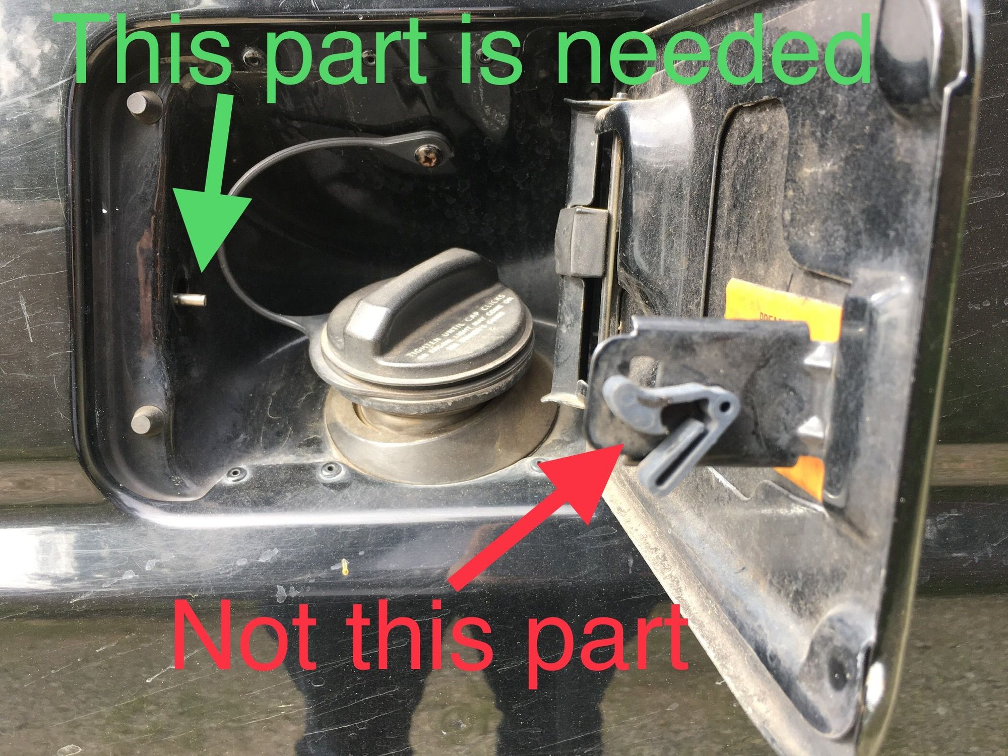

The fuel door on my DII is having some trouble. There was a sort of plastic retaining part on the body of the vehicle (not the part on the fuel door itself), which I’ve been searching for. I thought the BPX700010 part was the right part, but that’s the part on the fuel door itself, which is in working order on my vehicle.
Does anyone know where to find the other part? I’ve linked images of the fuel door on my DII that should help explain what I’m looking for. NOTE: currently, there is a metal pole sticking out of the hole in the vehicle’s body where the missing part was. I’m guessing this part is electronically controlled by the button next to the steering wheel, and when the button is pushed, the pole is pulled into the vehicle, unlocking the fuel door. Currently, the fuel door will grab onto this pole and stay shut, but without the part on this metal pole, it retracts into the vehicle and needs to be fished out each time.
Any ideas? The other part is all I can find. This is the incorrect part: https://www.island-4x4.co.uk/fuel-fi...9-p-13839.html
Cheers

The little metal thingy is the Fuel Door Actuator, or plunger.
To REPLACE it, you will need to remove the interior panels behind the fuel door. You will need to start at the rear door, and remove the UPPER and LOWER panels. There are 2 bolts which hole the 4-5" rod and its motor/actuator in place. Remove those and disconnect the connectors. You will find the part in between the metal panels.
INSTALL your new/used part.
NOTE: IF the tiny little black thingy on the fuel door is missing, then your fuel door will NOT STAY CLOSED.

the clip in your pic that says not this part is what attaches to that, but your clip is down and not lining up with the pin, get a new clip

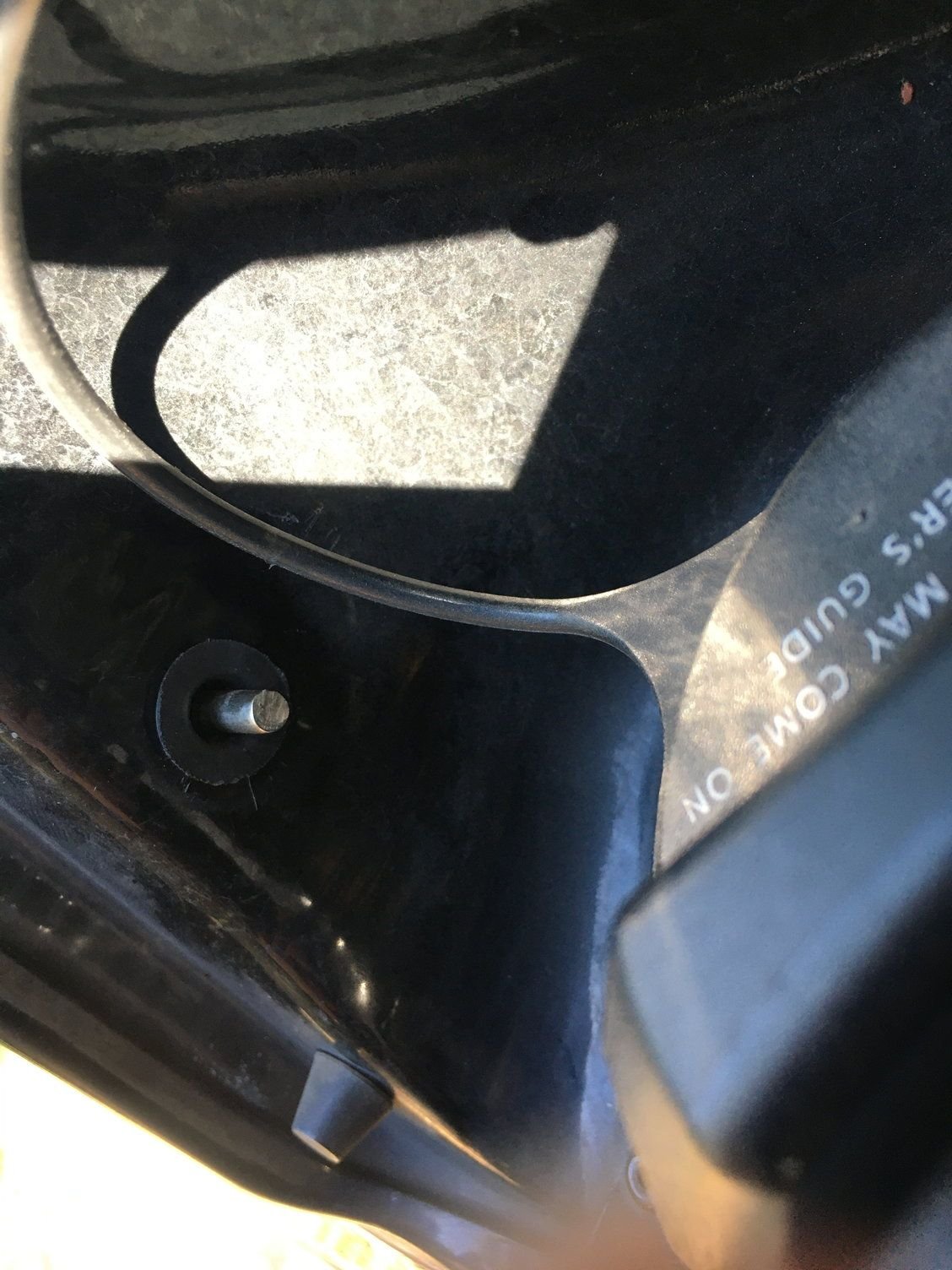

Check that the issue isn’t the grommet. It could be a fuse or the actuator itself, but in my case, the grommet had fallen apart prevent the door from releasing properly.
I’m pasting what I did from the other thread I’d originally shared this in, but it makes more sense to have it here:

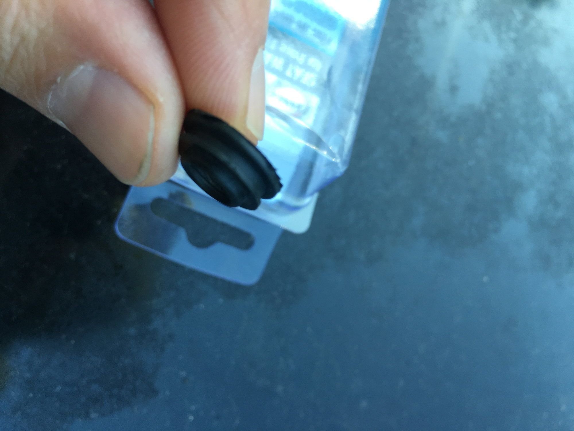

This is how I dealt with the grommet issue - bought this part at Home Depot for $2 (2 Pack) and shoved it in there, which took some work and the help of a very small flathead screwdriver. The hole in the body where the actuator solenoid pin sticks out is about 3/8”. This grommet holds the pin well and it works very well. The clip on the fuel door has no problem grabbing it easily each them and letting it loose. The pin doesn’t get lost behind the sheet metal body anymore. There are grommets you can buy online (maybe one that’s about 3/8-1/2”) and you can punch a hole through it if it’s a blank grommet. There are grommet sets on eBay for about $8.
