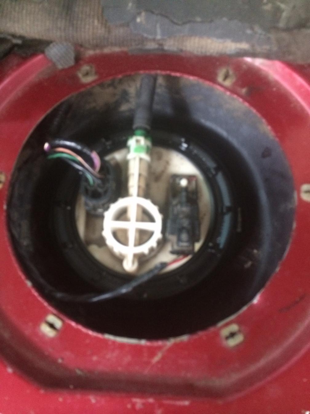

Here is a look at the part

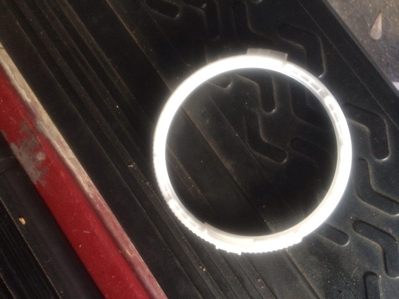

Another

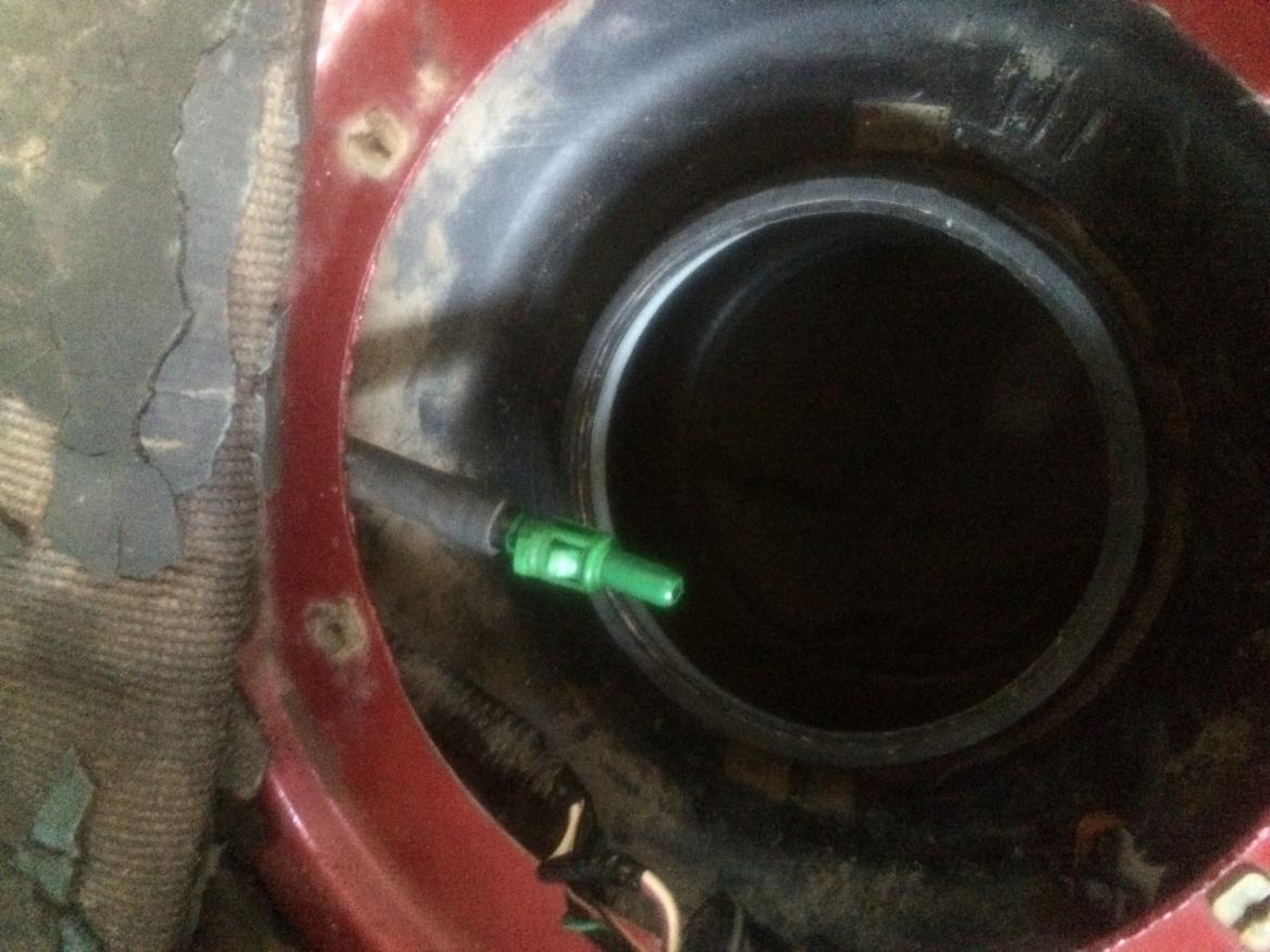

Installed the adapter ring and got the seal in. Here's a pic of the finished stuff. Had to use wd40 and used the locking ring to spin the adapter on.

I pulled because I had a recurring evap code. The ring was cracked and seal was folded. The truck runs fine now. My pump wasn't cracked. Good for me��

Sorry forgot to mention. I filled up one day and I had some fuel spillage. Checked and found that ring rusted and the locking ring loose. Replaced both to avoid future problems.
