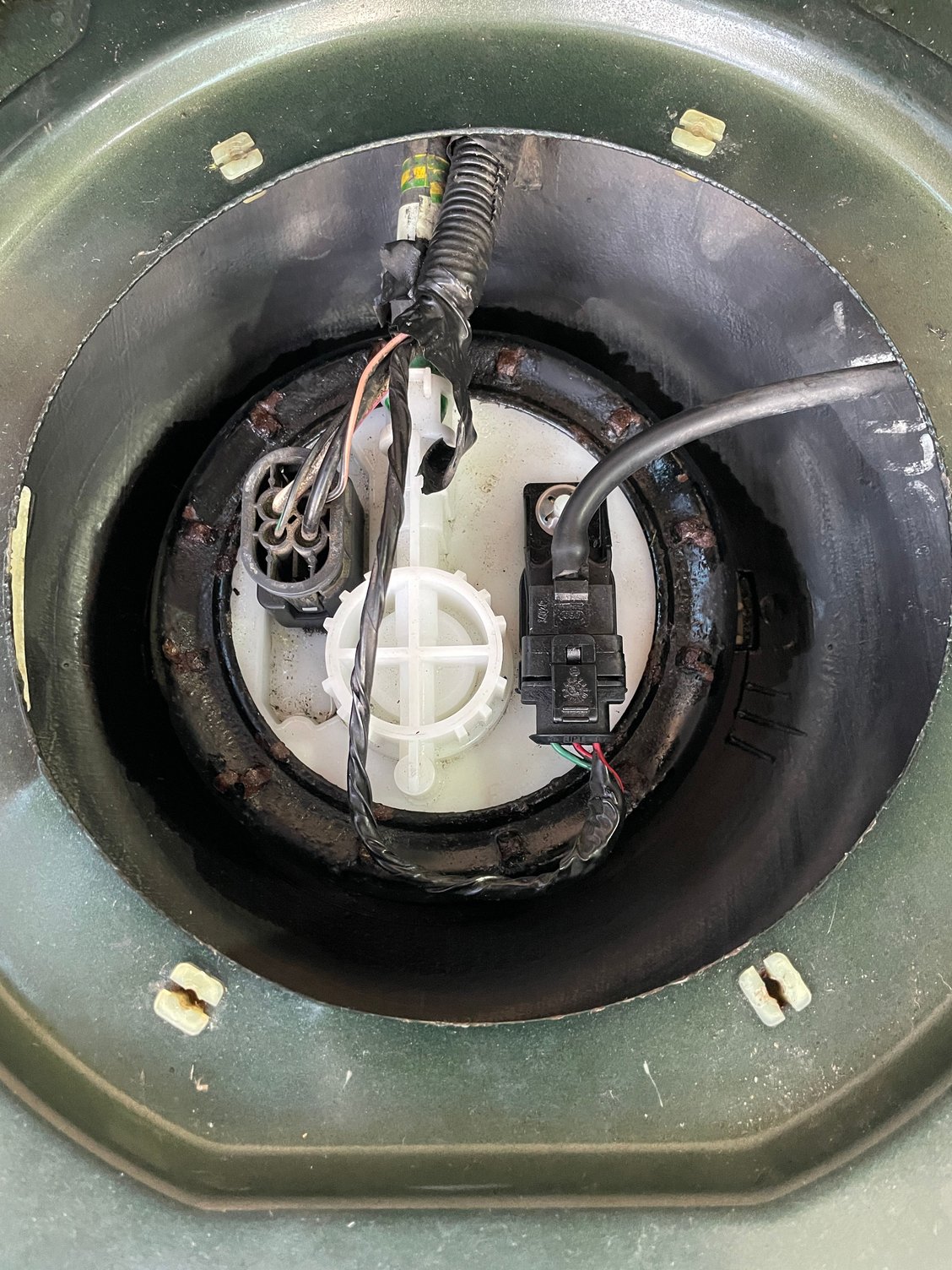

My friend and I met at a gas station to try to find the source of the leak.
He replaced the fuel pump several weeks ago, so in addition to keeping an eye under the truck we pulled back the carpet and removed the fuel pump access panel. As the tank approached full, the leak became apparent.
The “moat” around the top of the fuel pump began filling with gasoline, indicating the fuel pump locking ring. He told me he didn’t replace the sealing ring that’s under the locking ring when he replaced the pump, so now he gets to disconnect the wiring and the fuel line to remove the locking ring and install a new sealing ring.
The electrical connectors are easy, but he said reconnecting the fuel line was a bit of a struggle he’s not looking forward to doing again. I took the pic after we’d mopped up the spilled gas. I wish I had taken it showing the fuel in the moat.
This doesn't explain the "belch" noise my friend described, but the leak is the same as zski128 described.
