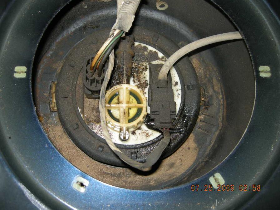

Question Fuel leak update
Ok I removed the carpet and interior to access the fuel pump. I noticed the top of the pump was wet and had some residual fuel in the top, looks like the main connection, is white and directly on top. Anyhow I started the truck and as it ran fuel slowly filled the top of the connector up and began to run out. Is that a bad connector/fitting or what??? I have attached some pics to help make some sense of my description.
Thanks
Rob

Old Jul 24, 2009 | 06:43 PM
Spike555's Avatar
Team Owner
Joined: Jun 2007
Posts: 26,212
Likes: 98
From: Grand Rapids MI
Clean it, dry it, and seal it with RTV that is gas proof.
Fill the whole top thingy that has the "T" in it with the RTV, let it cure before you run the engine and then see if it still leaks.
You should be good after that though.
