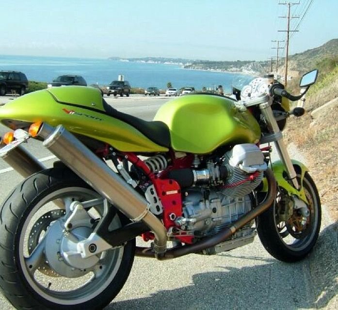

If a Moto Guzzi owner says it, then it must be true!
Included my old Moto Guzzi for reference.
