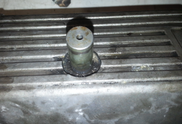

Your oil leak is caused by a plugged valve cover breather baffle, do the PCV mod and they will go away. I would not worry about the timing chain, they don't usually give trouble below 300k miles.

They only have a tendency to leak when there is internal pressure in the crankcase. The oil drains from the top of the heads down to the pan, the only way it can leak out of the intake or front cover is if it is blown out by pressure. Super easy test that will tell you for sure. Take the oil filler cap off with the engine running and stretch a surgical glove or balloon over the neck. It should be sucked in slightly. If not, or if it is blown out, you have a plugged baffle.

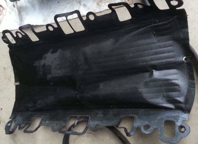

The factory crankcase vent hose on the drivers side is kinked. Reckon that would do it? Its raining now so not going out with the surgical glove tonight. Passenger side has the FV308 correctly installed. Drove it to a continuing ed class today and it puked in their parking lot. I studied the pattern and I think more is at the rear than the front now, but I guess it can be getting blown back there at speed. Ive got a lower manifold gasket set. I'm thinking its not sealed up front and rear correctly. I know most engines require extra diligence in that area and perhaps some permeates to boot. I'm going to study the rave shortly.

I bought a 2003 with a blown lower intake gasket from internal crankcase pressure. Previous owner paid a shop to change the gasket for $1500, they changed it and did not correct the plugged baffle, it ballooned the gasket again and blew the end seal out at the back of the engine. I stopped at the Walmart and bought 4 gallons of motor oil before leaving Orlando and drove it home to Greenville SC 8 hrs away, it leaked 2 quarts every 60 miles. Got it home and changed the lower gasket and did the pcv mod, still running fine (wifes DD).
Also, you need to cut the top off the tube in the baffle, they restricted the baffle starting in 03 to reduce the flow of crankcase gases in to the intake to reduce emissions. It causes more pressure in the crankcase.

Drilled it out to 5/16 when I did the mod.
Not to freak you out, but how did you get the chips out of the tube after? I hope you removed the baffle inside the valve cover. For others reading this thready, A garden variety mini tubing cutter does a good job without making any chips.

Had it out of the valve cover for the surgery.
