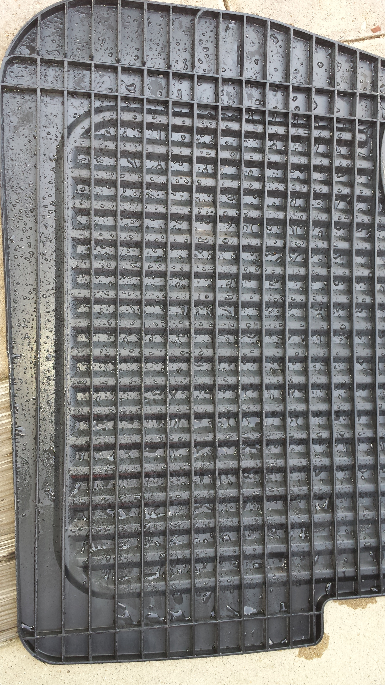

I noticed my car smelled very muggy about a week ago and saw this this morning. I got water all over the floor passenger side. I am ruling out heater core as it's water and not coolant. What I have noticed is that I run my AC all the time and never see a water puddle under my car. Is something clogged somewhere?

It's either your AC drains or sun roof drains. AC drains usually leak down the trans tunnel hump.

X2 on the ac drains

mine looked just like that and both a/c drains were clogged. carpet has been dry for 2 months now.

Usually you will get a musty odor insteed of that sweet coolant odor.

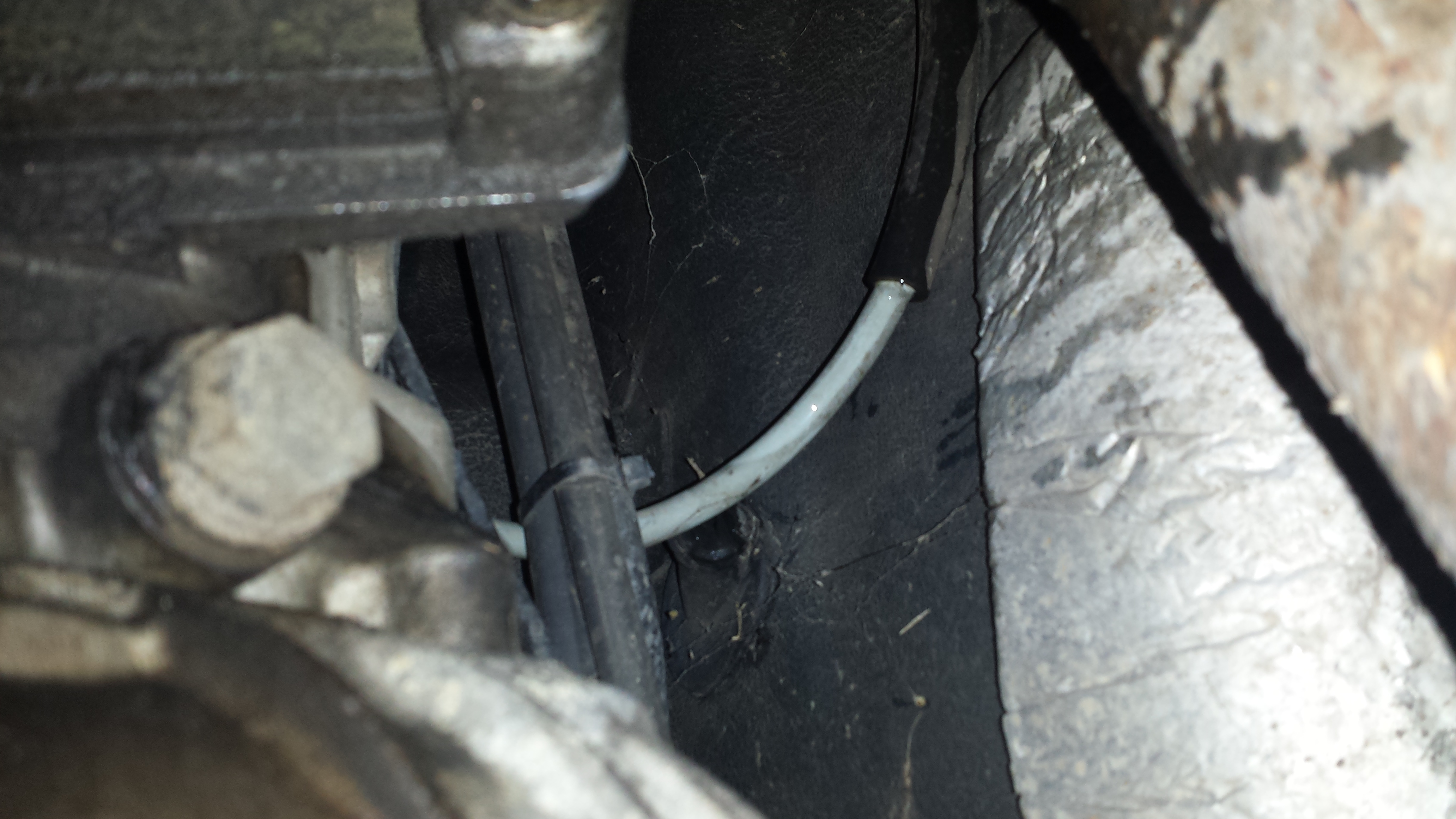

Thanks guys. Used this link to point me in the right direction.
https://landroverforums.com/forum/di...se-help-52320/
Both AC Drains clogged. I took pics of location as well as gunk before and after cleaning. They are both on the trans tunnel pretty much next to the trans filter cover.
Used a metal hanger to initially poke it and a stream of water came out. Used my wet/dry vacuum to pull most of the water off the carpet, front and rear.

I really don't understand what I am looking at in the 3rd and 4th pictures.
Those are what are located at the end of the drip tube. I removed one to clean it out. The other one is above the cat and if I remove it, I wont be able to put it back on. I used the hanger and finger to clean it out while still on the drip tube.

get a pair of long handle pliers...you can push it in the round tube...tight fit bit it works.
