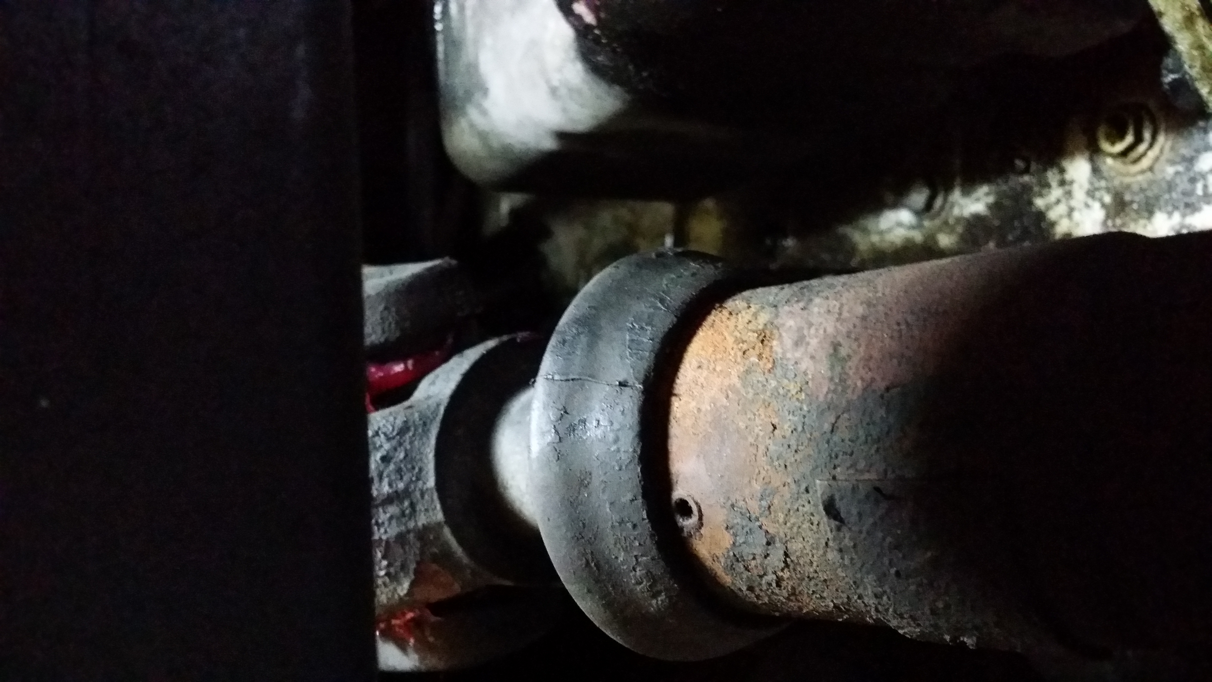

I have been reading about prop shaft Greasing points. I see people have 4 in front and 2 in Rear.
I can only find 3 in the front (not Stock I replaced locally few years ago)
and 2 in the rear
Am I missing something or this is the way this shaft was build ?
Attaching pic
Thanks

You should have a zerk (yours could have possibly, snapped off) on the shaft body itself. Located just behind the gaitor. The zerk feeds grease to the splines on the shaft.

After good look I found that point but looks flash. wonder if this is flash type or your theory the Zerk fell out. I dont want to force something in it. may be get a Zerk to see if screws in or a special feeder attached to the grease guns end. I am about to go to Advanced Auto after dinner

Well after cleaning and taking a close look. Its a Hex screw. Now I am going to store to get some Zerk to replace that sucker.

make sure that you reinstall the screw after greasing so you don't throw off the shaft's balance.

I was thinking to replace the screw with Zerk but your advice makes sense.

I've read in a few places that you are supposed to take the zerk out of the shaft body because it can catch the frame rail or something when the front suspension is fully compressed. That seems like a stretch but I've never studied it that hard. Most likely it won't bother anything if you leave the grease zerk in like most people. Does it make you wonder if the shaft has ever been greased there? Don't forget to pump new grease until the old stuff comes out of all 4 caps. If you tap the yoke with a hammer you can sometimes get the grease to come out of the caps that aren't getting the new stuff fed into them...you know like when you pump, pump, pump but continuously comes out of the 1, same spot?

I left a zerk in on my Toyota Sequoia and it caused a vibration. It took me a while to figure out. In theory it should be ok because it is so small but even that could throw off the balance. I have even heard in some cases that caked on mud caused vibrations. Better safe than sorry.

Thanks for all the advice. Used a Zerk to feed and put the screw back in. Not taking a chance. It's a minor details but worthy. You don't want something sticking out on a rotating shaft. I used high temp Pink Grease just so I can see the old stuff clears up.
