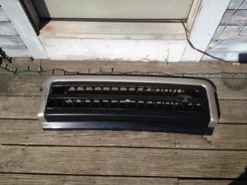

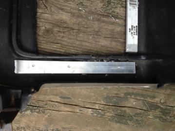

Finally figured out how to mount the grill mesh securely to D2 grill. I've included some pics.
Pic.1 before grill is cut - Make sure you pry landrover emblem off original grill carefully to epoxy on your new grill mesh

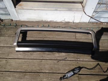

Pic. 2 after grill is cut
Pic. 3 Close up of how I planned on attaching the mesh. Instead of epoxying it directly to the plastic I bought two pieces of aluminum from home depot 1/8th thick 3/4" x 48".

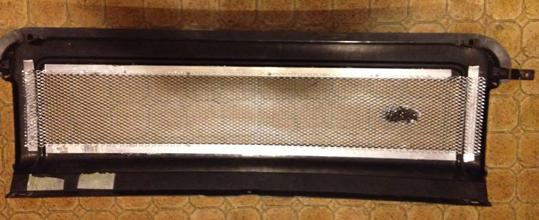

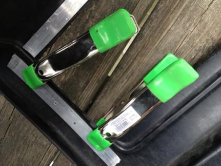

Next I cut the aluminum to length, top, bottom, both sides of inside grill. I epoxied the aluminum to the plastic, clamped, let dry.

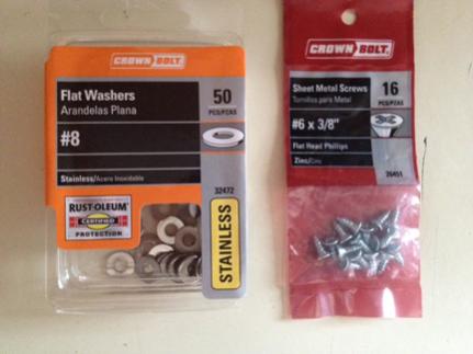

Next I put the grill mesh over the aluminum/lined up and pre drilled holes. I got washers & screws, see last pic to see size of screws/washers and spaced them across the mesh. Warning!!! Be very careful pre-drilling and make sure you don't drill all the way through the aluminum because if you do you might go through the plastic!

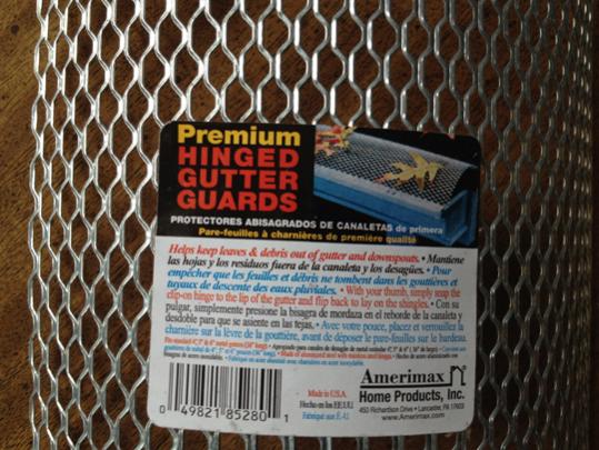

Finally finished, all I need to do is install it. Here are some pics. The mesh is from Home Depot, its a gutter guard and costs under $3.00. No cutting, its a perfect fit for the disco 2. You could spray paint it black if you'd like, but I like the stainless look.
