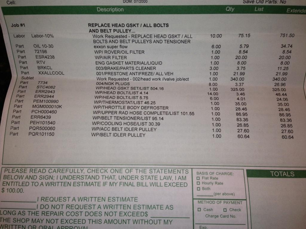

Just done in Jan 2013 here's the itemized:
