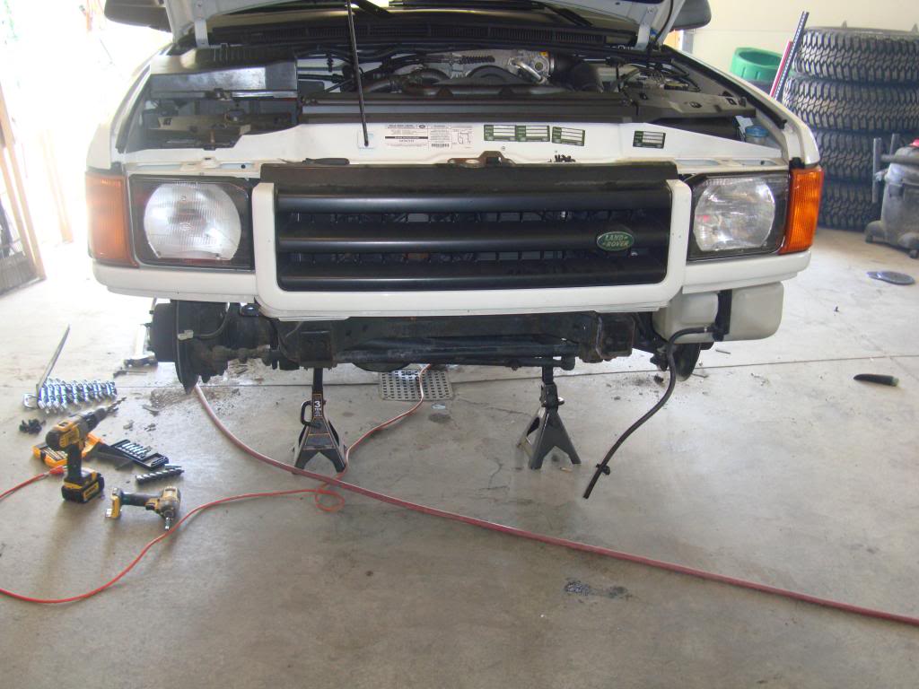

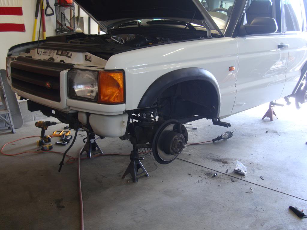

So I bought a 2000 D2 a couple of weeks ago and of course I have it in pieces in the garage.

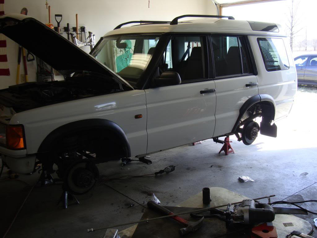

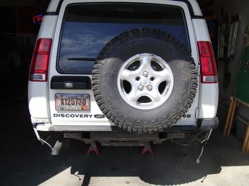

As it sits today

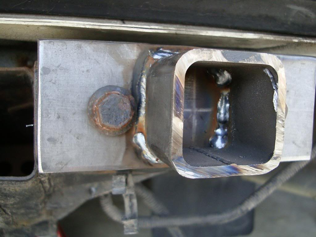

Working on the rear bumper today
making it out of 2"x4"x3/16" steel
Made up some quick mounts
Yes I know it looks crooked, I elongated the holes in the mount to allow for some adjustment of the bumper once its all put together.

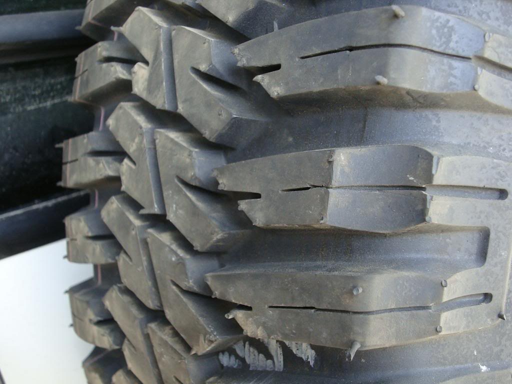

Heres the tires I picked for this project Treadwright Guard Dogs E Rated 285/75/R16's
