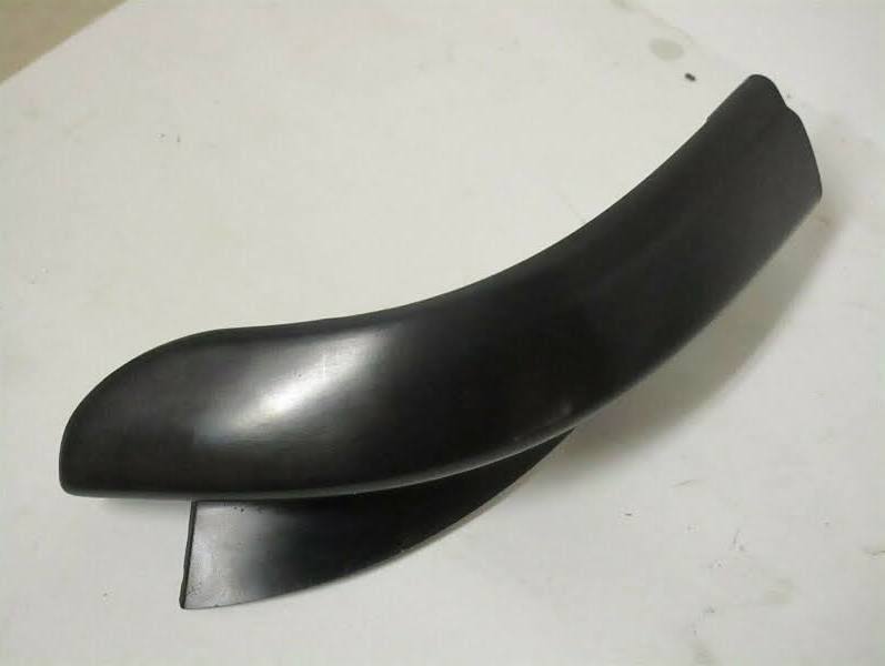

Has anyone 3D printed these drip rail/ drip rail finishers yet?

Have any of you 3D printing guys done these yet?

I have 2 printed front ones. Are you looking for tips? Someone to print them for you? The files?

Might be a big ask but I am looking for a finished product.
Doing a semi cosmetic restoration and need to replace all parts of the plastic drip rail pieces all the way around.
Has anyone found alternative materials for the long pieces that run the length of the roof?

I got mine printed through makexyz.com but there are other sites that you can match up with printers local or otherwise to get things printed.

I have printed a bunch of the front corners, can not do the long side bits. I am investigating the rear corners currently

@DiscoII-K your inbox is full but here are the files for the front corners :

I've tried to print them but it the part that is supposed to slide into the side gutter trim doesnt fit . you know the curl top part
How did you make that work ?

@tinybear I printed in resin but you may have to get a hobby file and adjust the at curl it is tight bend
