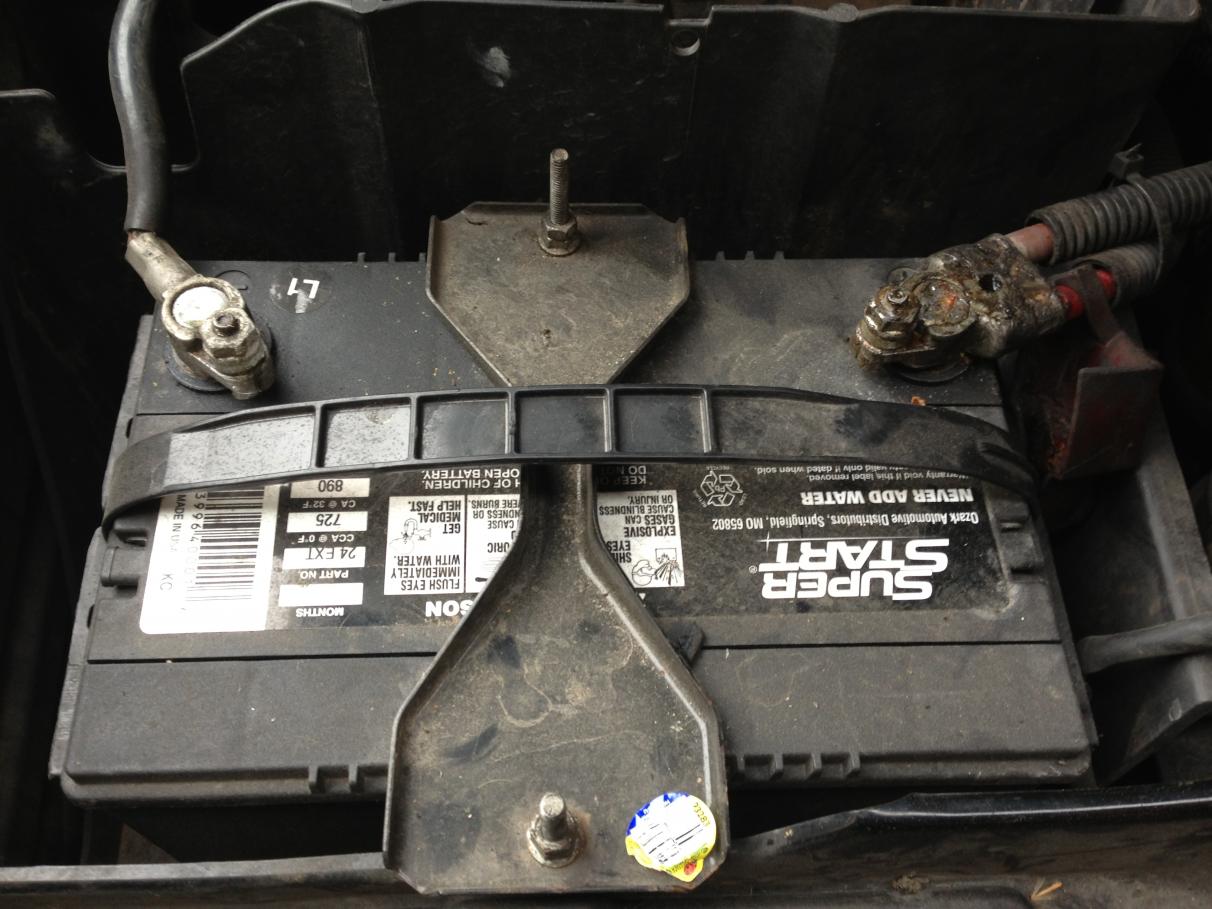

Loose terminals that need to be clean and tight.
I'll run out and grab a wire brush this morning to clean them off. They don't look terrible, but could use some scrubbing.

Don't worry about testing the voltage while not running, all that will show is a surface charge not the battery capacity at the time.
Pull the old battery, charge/test and replace it and you will probably be fine.
Probably the smartest move.
