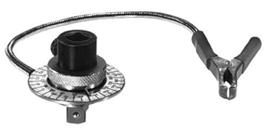

Originally Posted by FlyingZebra34
Ill try to mark it to make the 90 degree turn. I wish there was some torque figures to use. That would be so much easier!
Easier, but wrong. These are basically TTY bolts and to get even clamping the torque angle method must be used.
In the scheme of things, a torque angle gauge isn't very much money added to a head job.
Lisle 28100 Lisle 28100
$28 with free shipping.

Originally Posted by antichrist
What is the big alligator clip for? Just to ground the thing?
Old Jul 5, 2013 | 08:06 AM
turbodave's Avatar
Joined: Sep 2011
Posts: 141
Yes. And I can totally reccomend the Lisle angle gauge. I have tried several different ones (all basically the same design principle) and all are flawed in that when you put sideways load on them (un-avoidable when using a breaker bar as apposed to an impact gun) they can drag the needle, which results in you putting more angle than intended on there.
The Lisle is USA made as well - and all steel - and robust as robust can be. The aligator looks wierd, but is actually a lot more useful, steady, and robust than the bent piece of rod that comes with other angle meters too...
