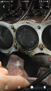

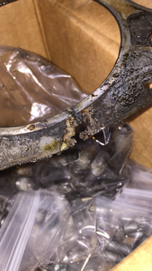

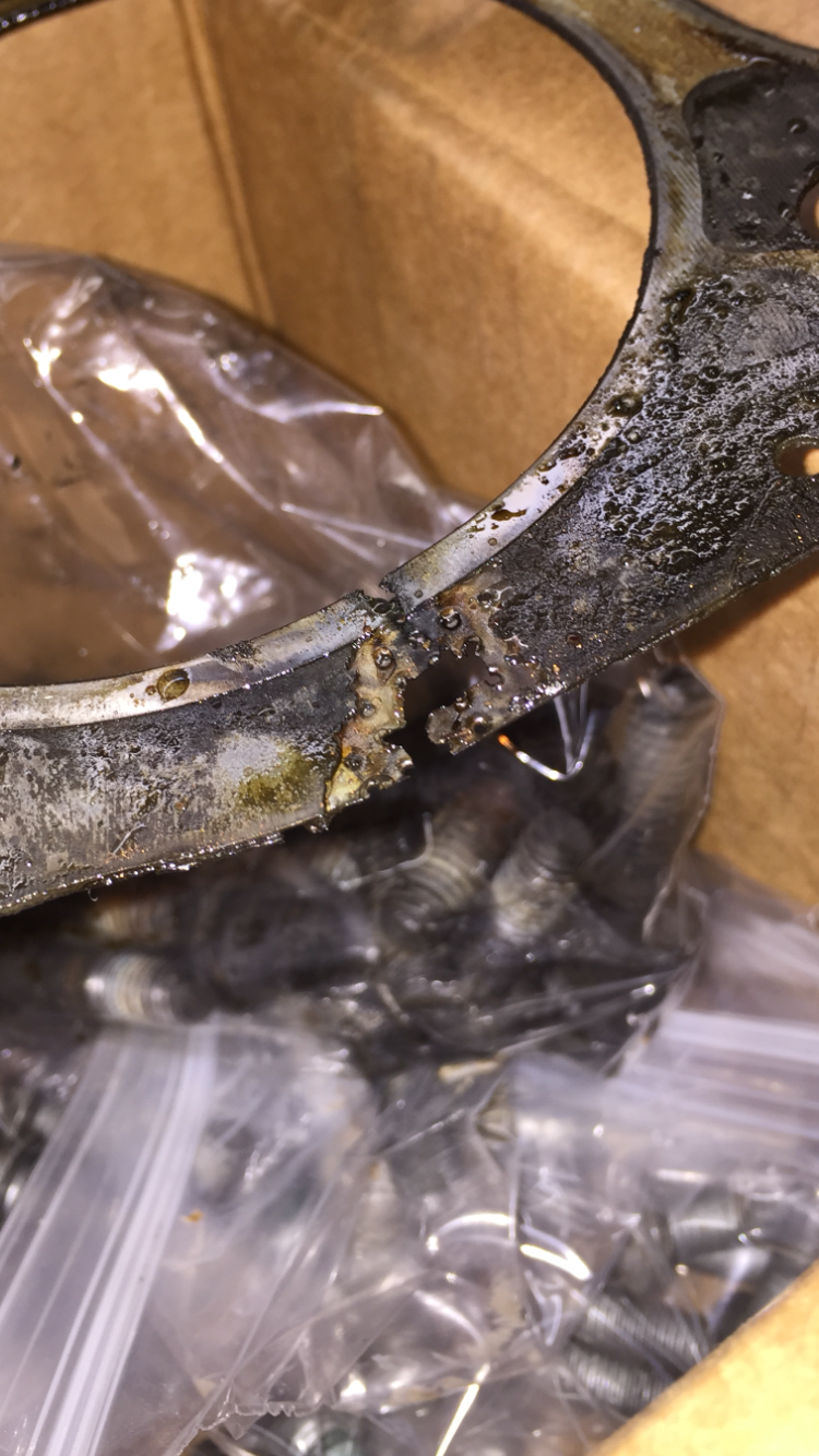

I’m starting to get a feeling you may be right. I was looking through my photos of the last head gasket change (March 2016, not quite as bad as I thought) and the gasket was 99% failed in the exact same place. No symptoms from that- it was overheating because of a leak on the other side into the coolant- but it was about to. It seems there is something about that spot. Here are some before pictures. The heads were machined and everything was clean when I put it together, but it didn’t check the block....
