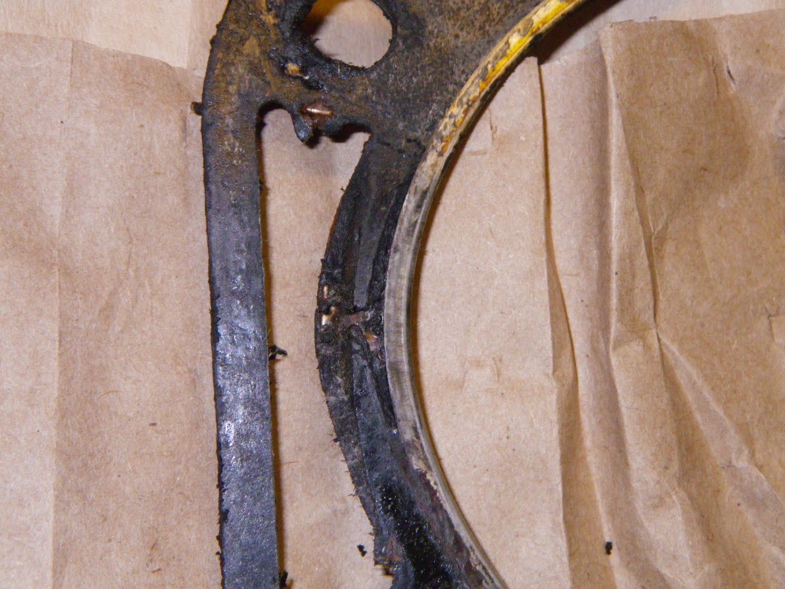

I'll throw my experience into the ring: I had a slow coolant loss problem that went on for several weeks and a few hundred miles. It quickly and spectacularly turned into a fast coolant loss problem with lots of steam and warning lights flashing (CEL and overtemp light on temperature guage). Did the head gasket replacement myself and all was well for about 1500 miles when the other head gasket went. So, I got to do it all again for the other side. Here is a pic of the portion of the gasket where it failed:
http://3.bp.blogspot.com/-JdobAI50i1...600/Gasket.JPG
If you're interested in the whole story on the first one, it's here: Home Shop Diary: Discovery Head Gasket
The second one failed in just about the same place...
If it were me, I would strongly consider getting it fixed before your long trip as you have no idea when or where it will eventually let go completely. You may make it all the way to Denver, or.....
