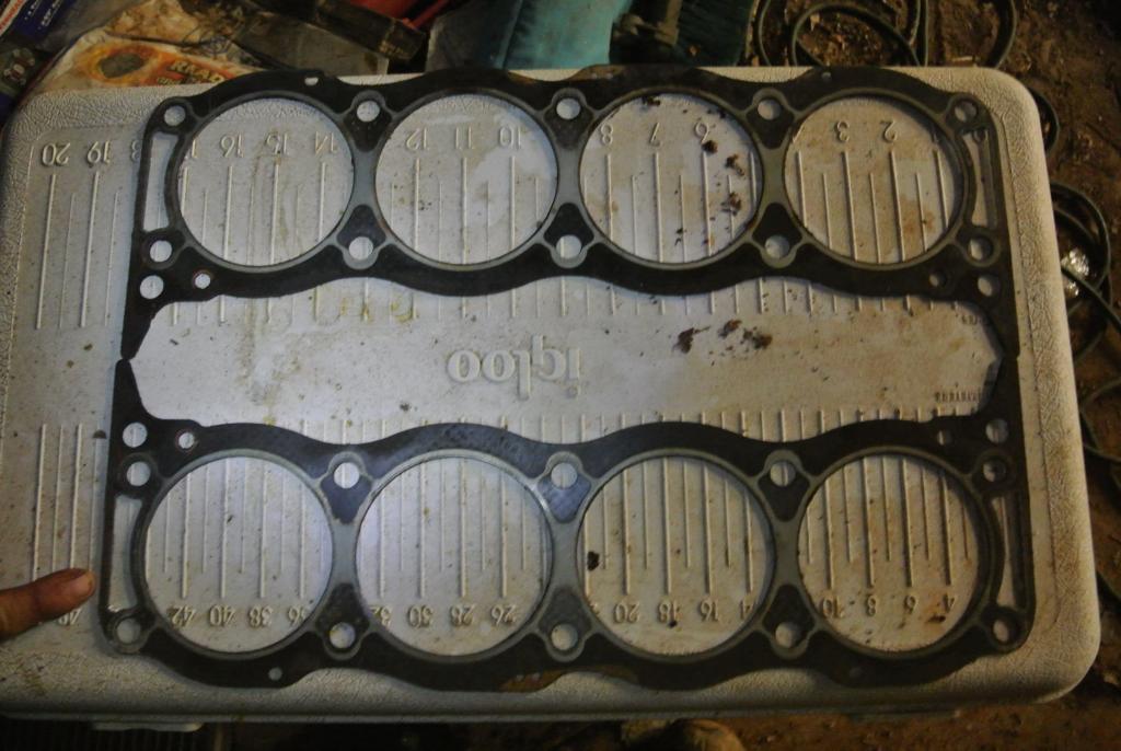

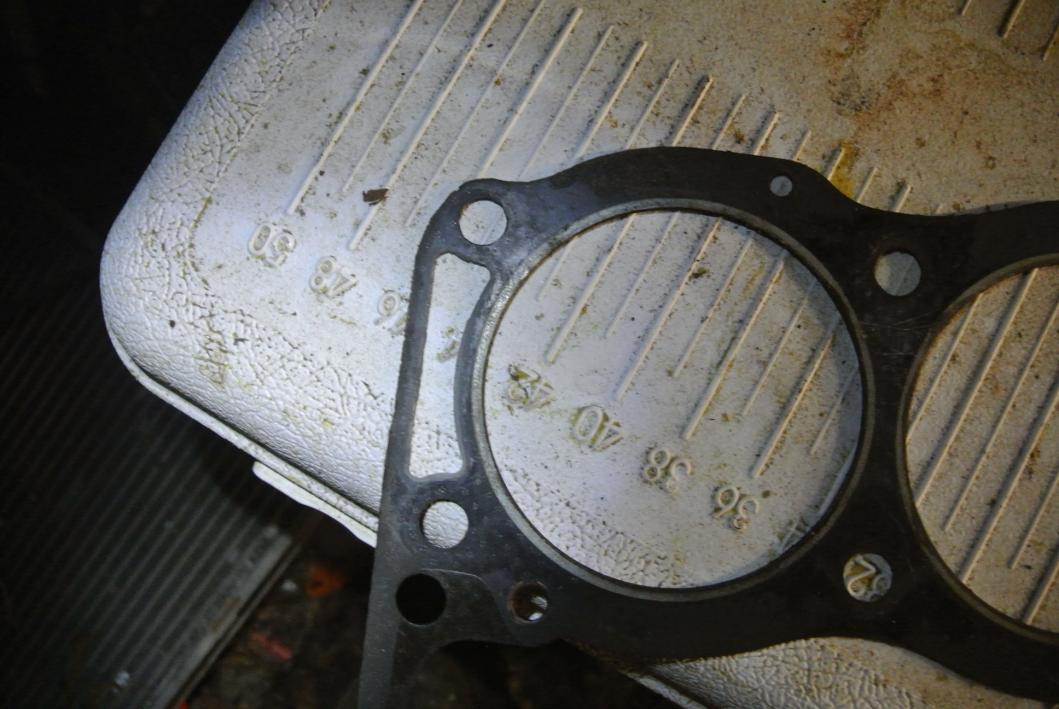

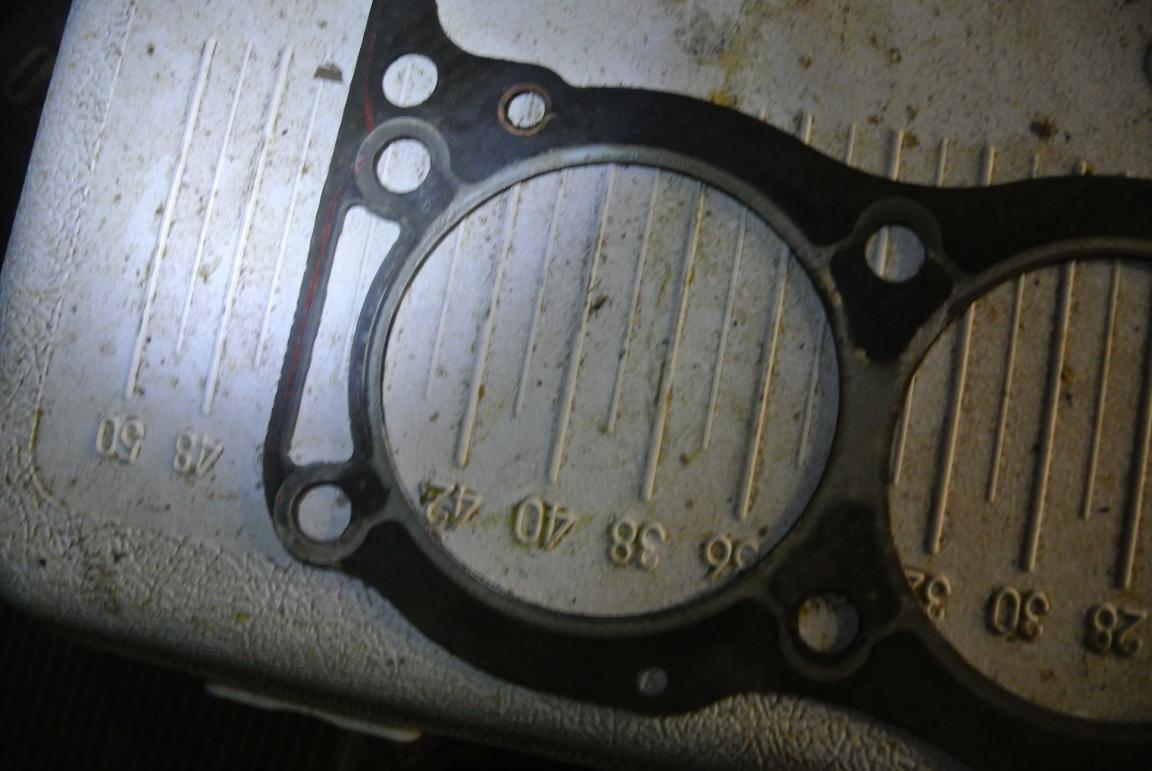

Just a little info on my findings: my head gasket leak at the back of the passenger side head, was only there with the additional water pressure of my electric water pump. I assumed that I had some deterioration and it was bound to be a failure in no time. I took the time to torque off the bolts on that side. I found that both of the back bolts, top and bottom, were significantly less tight than the rest. In fact, the same was true for the other side that was not leaking. I broke both of those bolts loose with a little three eights socket and ratchet. as seen in photos, my original head gaskets looked brand-new. still had the raised red ridge.

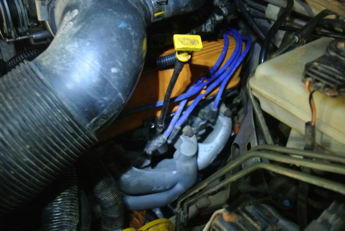

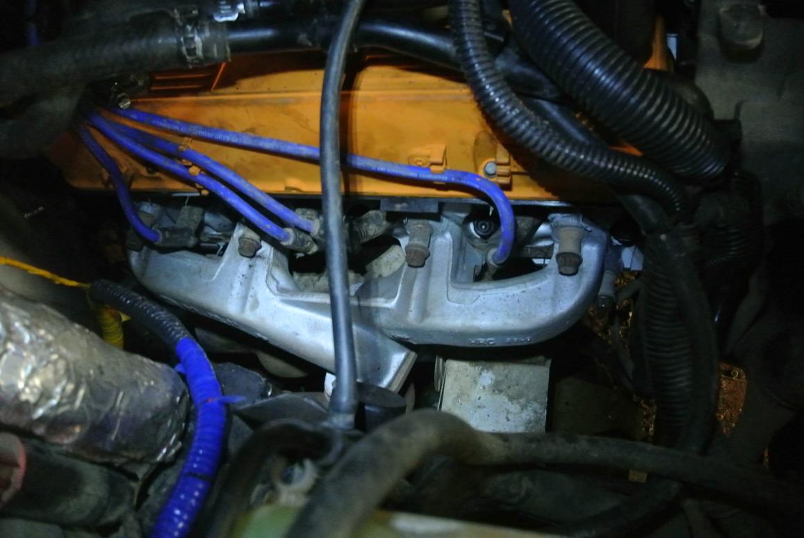

yes, and I coated all the metal coolant pipes, and the valve covers (figured it would be easier to find any new leaks)
