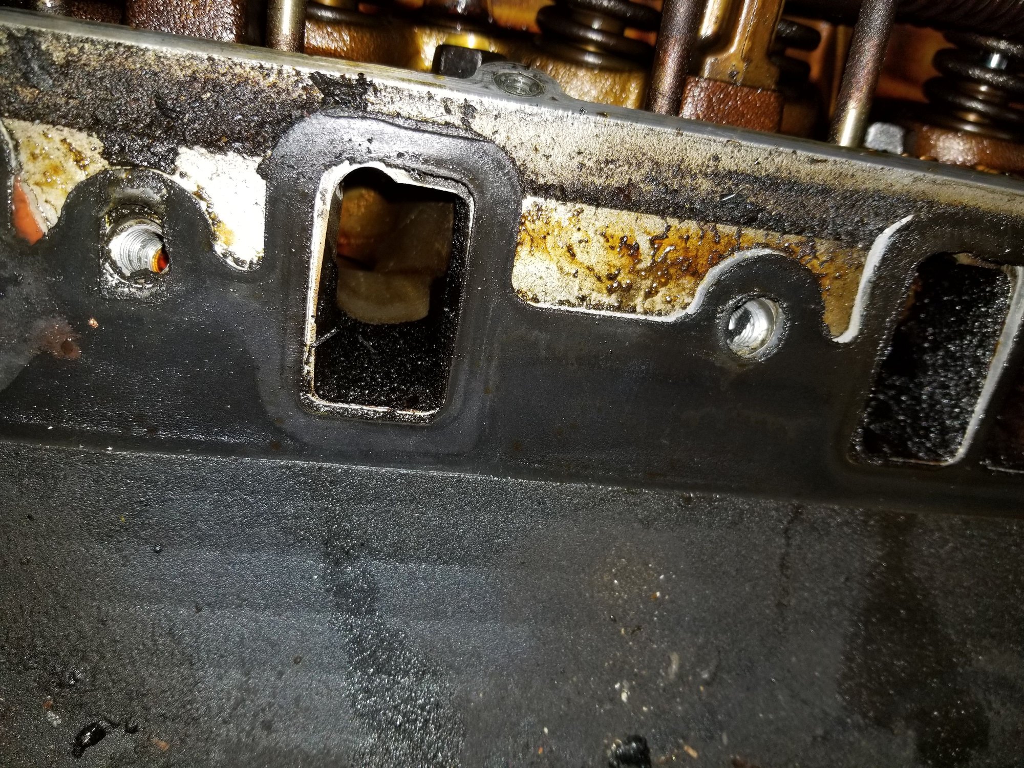

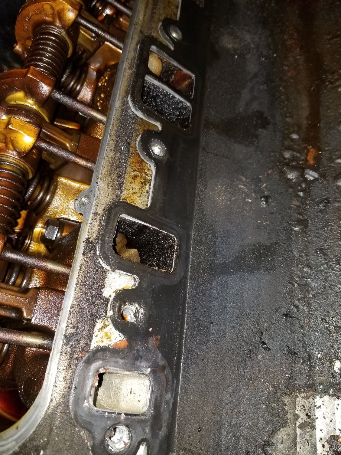

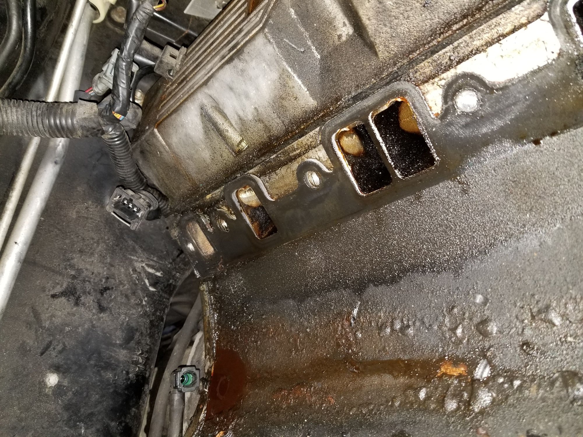

eskiltell
Joined:
May 2016
Posts:
102
Likes:
From:
Northern Virginia
here's what im talking about
eskiltell
View Public Profile
Send a private message to eskiltell
Find all posts by eskiltell

39
shanechevelle
Joined:
Oct 2011
Posts:
1,709
Likes:
137
From:
NE PA
I threw mine in the parts washer too...but I still clean every nook.
That black stuff is the coating on the intake gasket.
shanechevelle
View Public Profile
Send a private message to shanechevelle
Find all posts by shanechevelle

eskiltell
Joined:
May 2016
Posts:
102
Likes:
From:
Northern Virginia
No the black INSIDE the air holes
