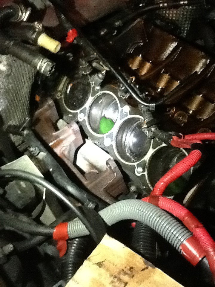

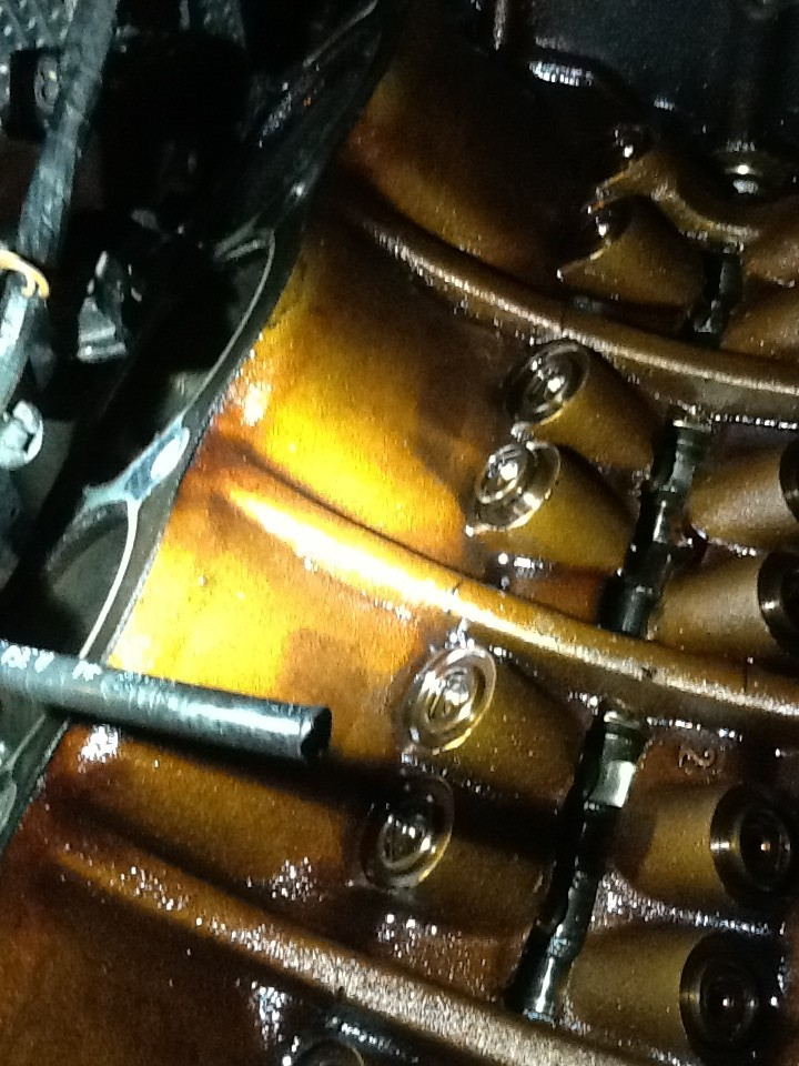

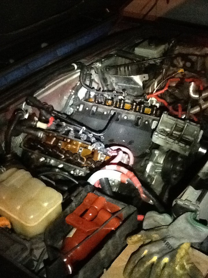

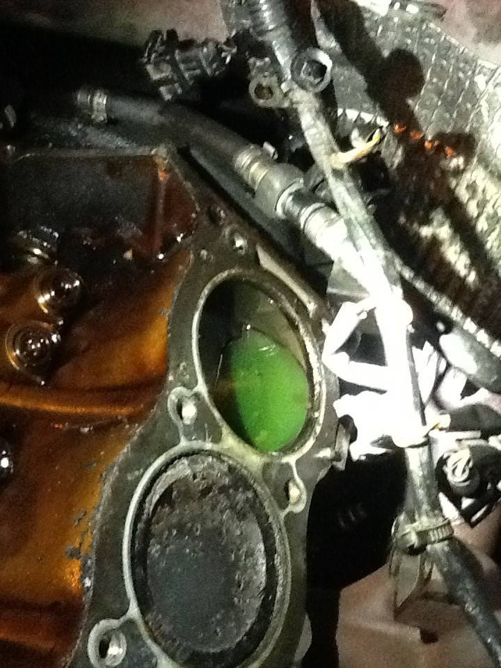

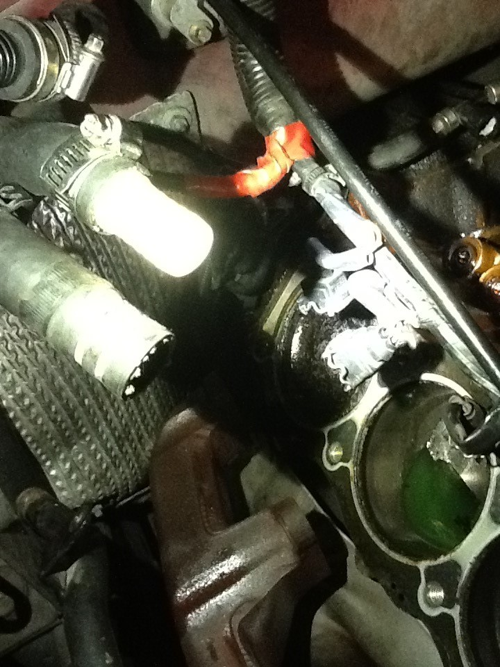

that looks amazing! I got my heads off last night and dropped-off at the shop for reman. they are going to wash the lower intake manifold too, extra $20 well worth it b'cause they couldn't look any worse if they were hit with a meteorite and then glazed in Gorilla Glue before being dropped into some unrefined petroleum.
I was looking for a new D-1 thermostat housing so that I could have the lower manifold machined to accept a traditional stat, but I came up empty. I could go search for a SBC housing and see if I come up with one today but I would still need to make a LOT happen tomorrow in order to bring this mod to fruition as I need to begin reassembly ASAP.
Other than trying to fulfill this fantasy I have had for over 1-year now, I didn't see anything alarming with my block. There was no obvious damage to either head gasket. I could see where some of the factory red sealant was missing from the water-jacket end so unless coolant was seeping from there, then it was coming from the front of the lower manifold or engine cover, running down the valley gasket, out the back and down the rear of the engine.
PS: what is the best way to get the crud out of the valley area? In the end, I forgot the 2 ground straps on the back of cyl-head and paid the price for that including what looks like an engine flush and oil-refill due to the extreme amount of debris that I allowed to fall in the middle.

Looking good. I know so folks might cringe at this but I pulled the lifters (put them back in their correct order they were removed) and sprayed it down with brake clean real good. I didn't have a lot of gunk build up so I didn't have alot gunk to scrape(with a plastic scraper of course) and then wiped it down real good with a lint free rag soaked in sea foam. I then wiped it all down well with a lint free cloth and then poured clean oil over everything and replaced the lifters. After complete assembly, I'll fill with oil and drain it all before I ever turn it over.
