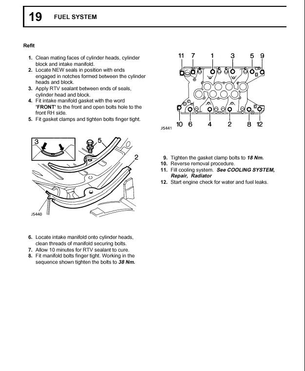

Does anyone know the torque sequence on the intake maiforld for a LR1 1997.

Do you have the RAVE manual? If not download it. You really shouldn't be working on a Rover without especially something major like head gaskets.

Default Rave Overhaul manual no fuel section
I can not find out where there is the fuel systems on this overhaul manual.
Is there one on there? Do I need to down load some other manual?
Thank you for the information about the Rave manual.

start at the beginning, go to Discovery, then workshop manual, then fuel system. You have the SFI, but the intake procedure is under MFI
