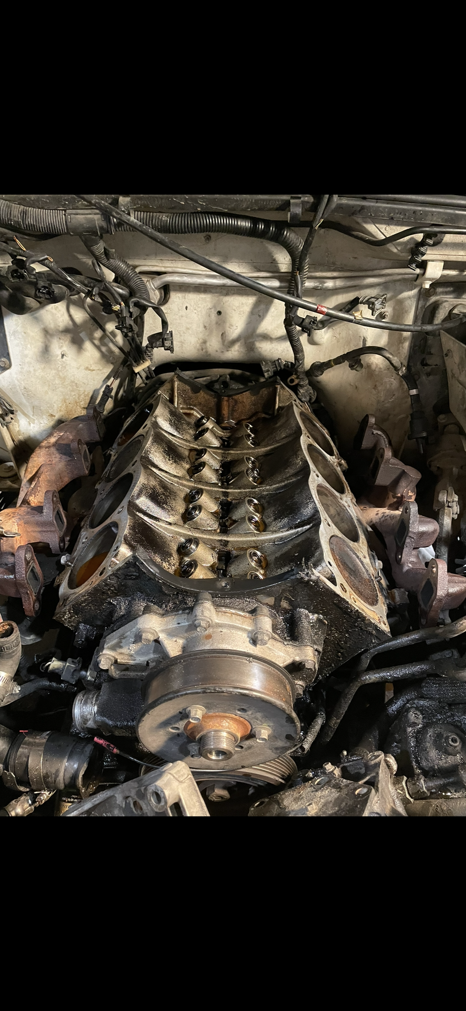

Outside compression leak #6 cylinder. Same exact place it blew 60k miles ago. Gasket blows on the block side, there is a defect but wasn’t really excited about pulling the block and having it decked. I can do head gaskets in my sleep so if I get 60k out of this set I’ll be pleased.

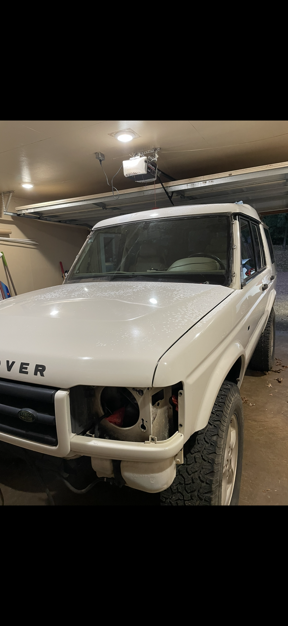

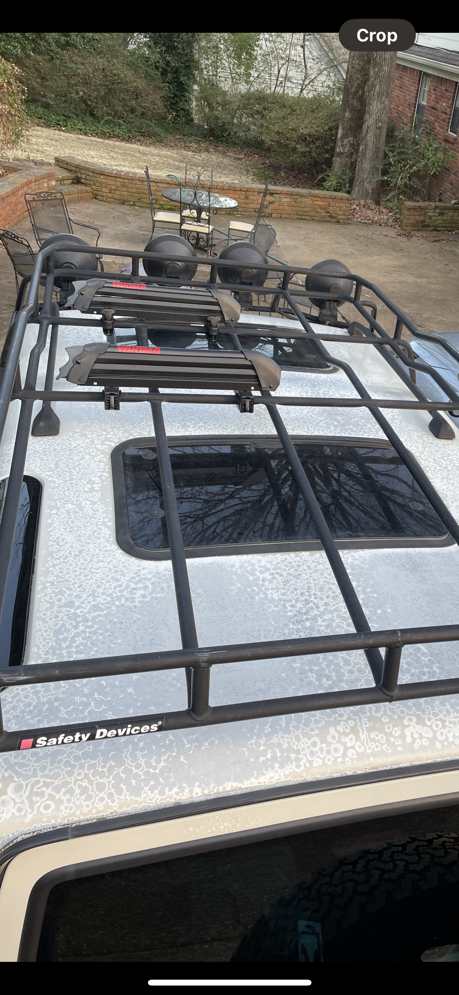

Worst of the paint deterioration. The tops of the fenders and parts of the hood were headed in this direction. If you touched the hood or fenders you hand would be white.
Almost everything off.

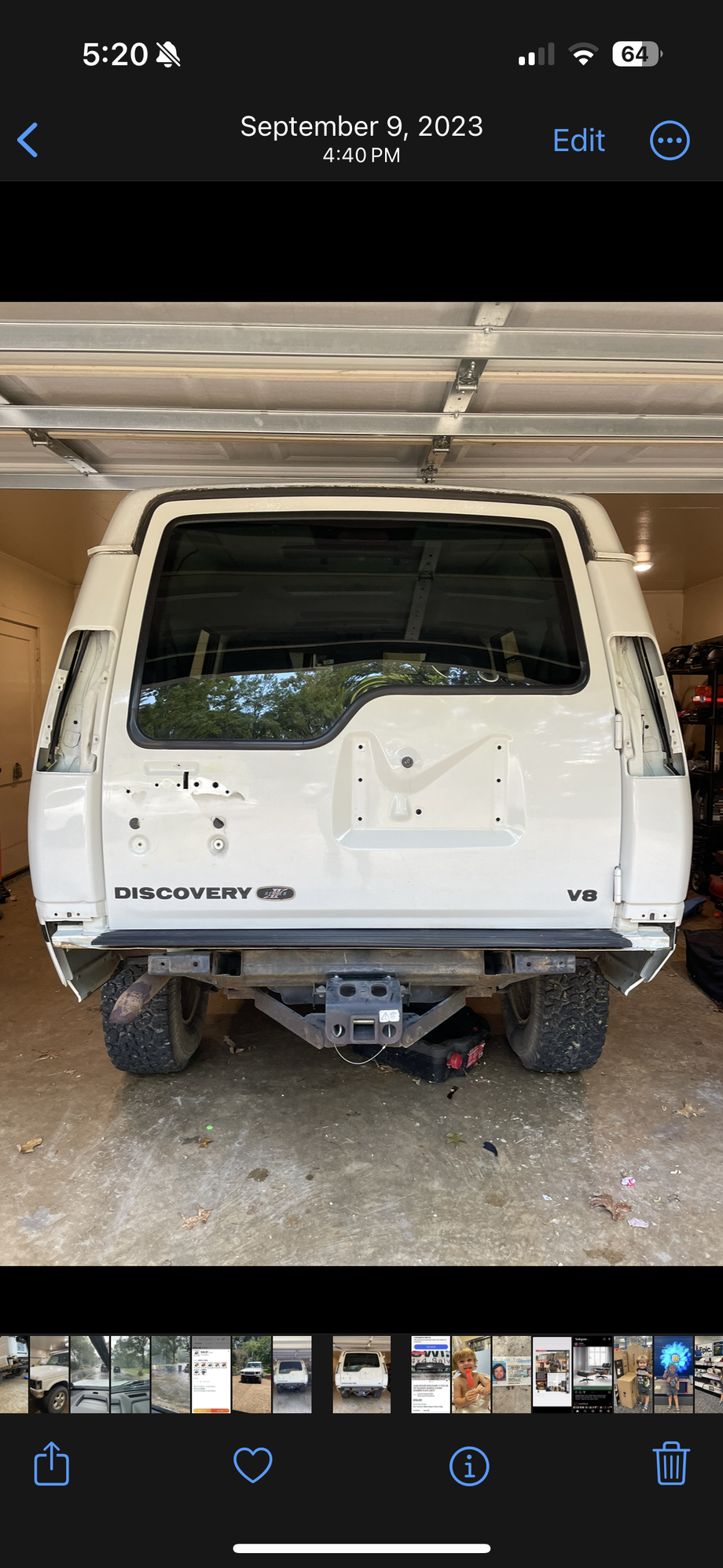

Bareback
Bareback

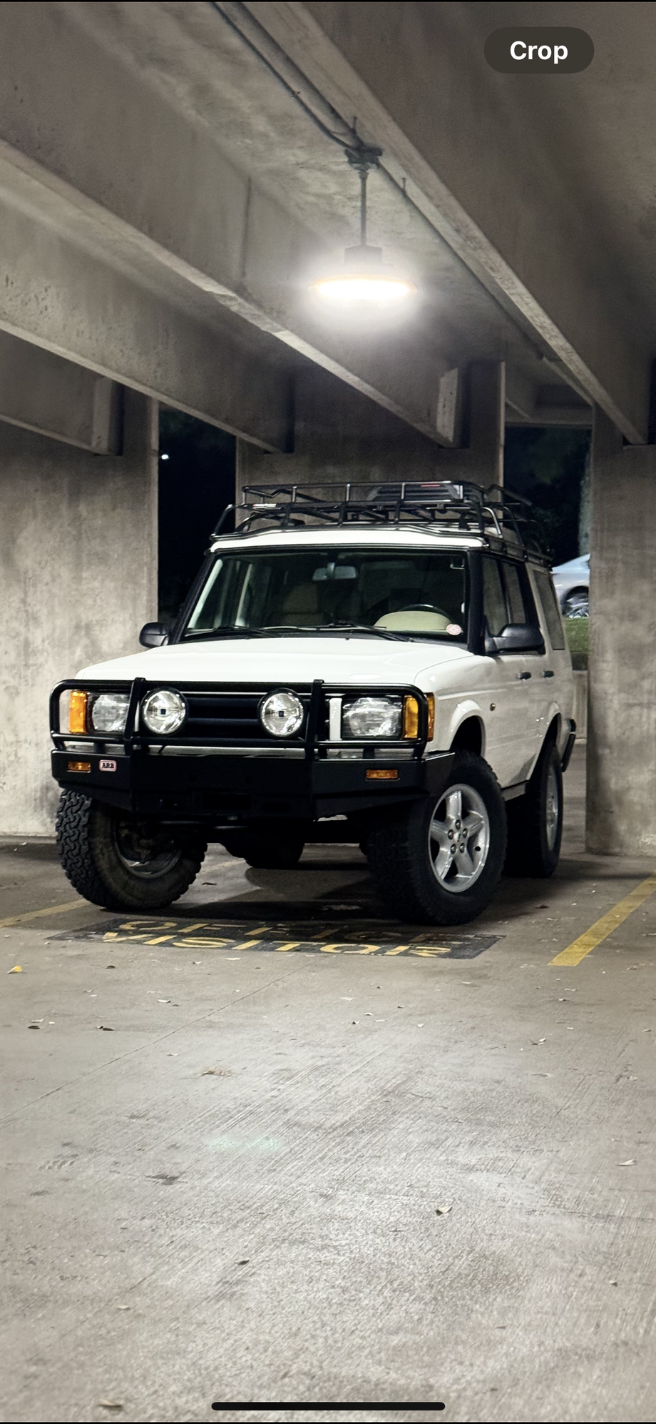

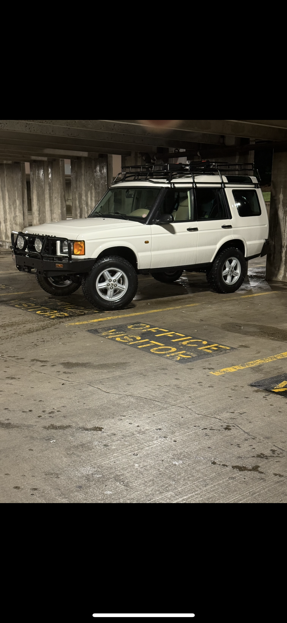

Fin
Fin
This truck is not my daily, I could have knocked it out much quicker but honestly my enthusiasm for the project ebbed and flowed.
Every piece of plastic except the side view mirrors is new. I didn’t get Land Rover drip rail trim though, hard to source all the way around. Used 1/4 inch rubber trim with 3M adhesive and it looks great. New badges all the way around, I found the only NEW OE in the plastic series II badge on the planet in the UK (only new one available at the time). New fender turn indicators, removed and resealed the sunroofs, new windshield, new windshield cowl, Discovery I wiper arms.
