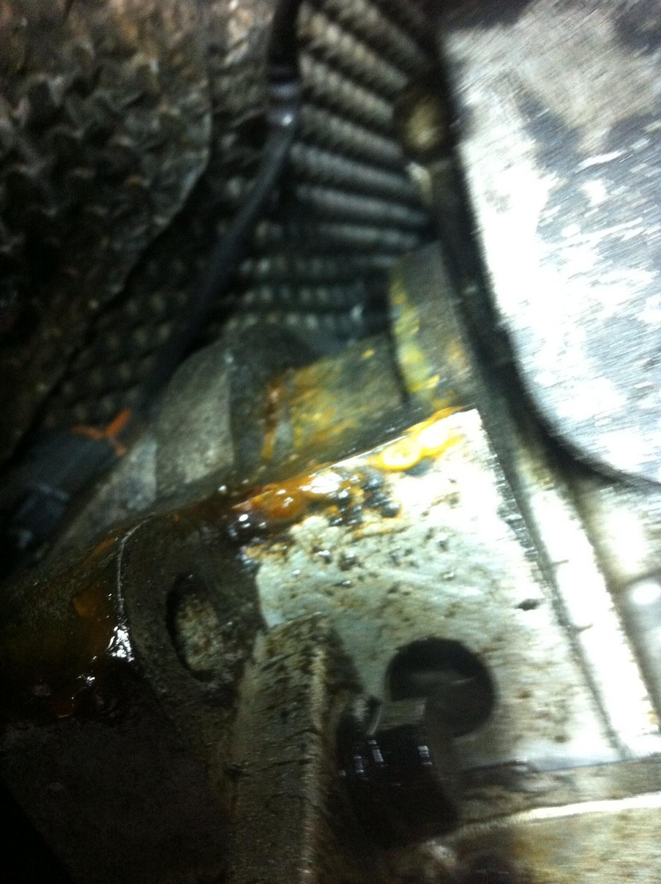

I'm not changing out the injectors. I'm more than happy with how this thing runs now so I'm not spending money to change it. No matter what I do, it's still going to be a heavy, ponderous truck. I just want to make sure it keeps running so I think keeping it from spewing coolant makes sense. I'll freshen up the oil pump and I guess I'll get the gears and chain while I'm at it and hopefully that will be it for a while.
By the way, here's a picture of a nice coolant stalactite by the starter in my truck. Sure looks like a head gasket.
