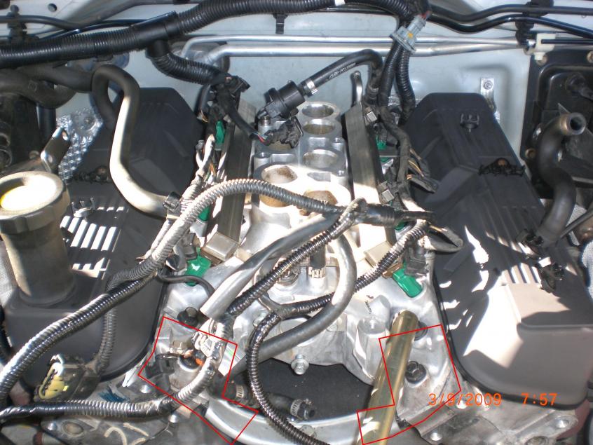

Already have the newer radiator hose. Got new bolts and t-stat. Heads were right at .002" gap around the coolant jackets. So they're getting re-surfaced. I'm also going to replace the valve cover bolts with socket cap screws, what size are those.. They look like 1/4-20x3/4, and 1/4-20x 1 1/4.
The valley pan gasket uses some in the corners where the block, heads, and intake come together?
That's how i did it....

I put gasket sealant here (in red) on the 4 corners/notches and around the coolant passages. Are you putting any gasket sealant on the headgaskets? I know RAVE says to fit them dry but I don't know...
